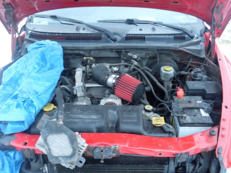

I thought cleaning your filter was common sense? Anyways there are dry filters that dont require oil, i have a aem dryflow on my dakota

Back when I had the opportunity to see dyno runs on a pretty regular basis, dry filters couldn't flow near what the oiled ones could BUT there has been a lot of newer technology in dry flow filters over the past 10 years. Now, the better ones flow just as well as the oiled ones but filter like a paper filter.
If I had to buy one today, I'd put a premium dry flow in. Plus maintenance is a lot easier...
