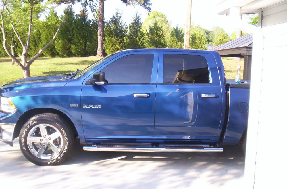

I finished removing the pillar block blackouts yesterday. It started out not so good. Then I moved the truck into direct sunshine and it made the job much easier. Here are a few pictures of the fun.
Thanks Jay. When I first started I was thinking I made a mistake. Then add some warm sun and bingo! Got much easier and them my wife helped me out too.
I am considering removing the big "Ram" badge on each side. The one on the door. Leave the "Hemi" badge alone. Have you ever removed these before? I know there are threads on this and I will check them out. Thanks Again.
John

Sometimes, less IS more. Looks alot nicer john...!
Debadge by using fishing line, use a back an forth sawing method behind the badge.
Ther will be some glue left behind on the door, i used denatured alcohol to remove the glue.
Then you will want to hand buff it with some swirl mark remover (from your local auto paint store)
Last but not least, use a good wax...DONE. Dont forget to post some pics when done.
