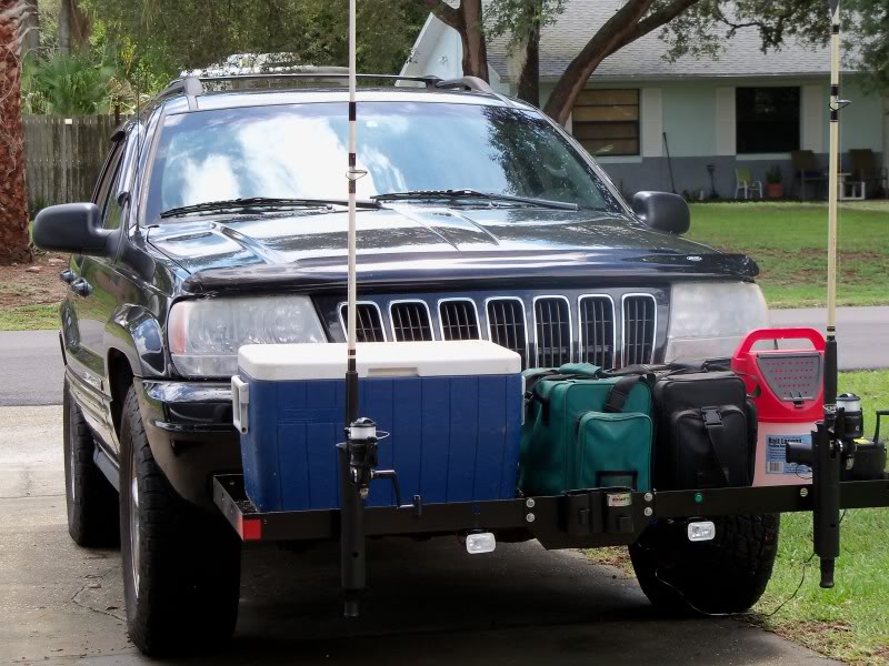

Yep, this is the fishing rig I made out of a Hitch Haul. Complete with rod holders, cup/gear holders, lights and a 12v outlet:

nice setup hammer, i have the same hitch haul just need to set it up similar to yours.
work, time, kids, and money been interfering with playtime though.
