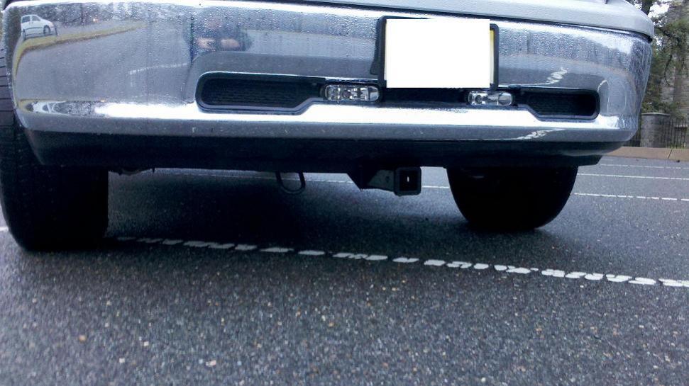

i have one on my 2009 SLT, the one from curt manufacturing. easy install, two bolts just install into tow hook inserts, and have to drill two holes.
i dont think it would be any different on a sport.
only downside is because it hangs down below the fascia/air dam, it is pretty low out front. my hitch rack for cooler and fishing hangs fairly low so i use my cousins which steps up higher. depending on what you want to use it for, you just need to make sure it will clear ground obstacles.
all in all i did it because it was about same price as adding tow hooks i didnt have, and it provides more then just a pull point.

yea... ive thought about making a flip mount for the hitch and bringing it up into the small grill opening like some of the ford ones im familiar with, but it would require cutting a little bit of the chromed metal out of the way. this might be easier to do on a sport model.
hammer, unfortunatly the way the 4th gen is made, no real way to bring any higher without modifying bumper. as it is, i had to notch the plastic out a little bit. I will post a picture later on when i have a moment. the other problem is that 4th gens just sit way to low.

i did not have tow hooks. i think it said to remove, but i dont see why they couldnt be used, must just require some shims and a small amount of modifications.
hammer, i totally agree, possibilities are endless. i also agree i wish it came out like yours, but the only way i see of doing it is to use 1.25 hitch or to cut bumper. main concern with cutting bumper is halting corrosion after doing it.
one of theses days when i have some time i'll drop hitch, use it as a template and weld up my own that fits through there one way or the other.
