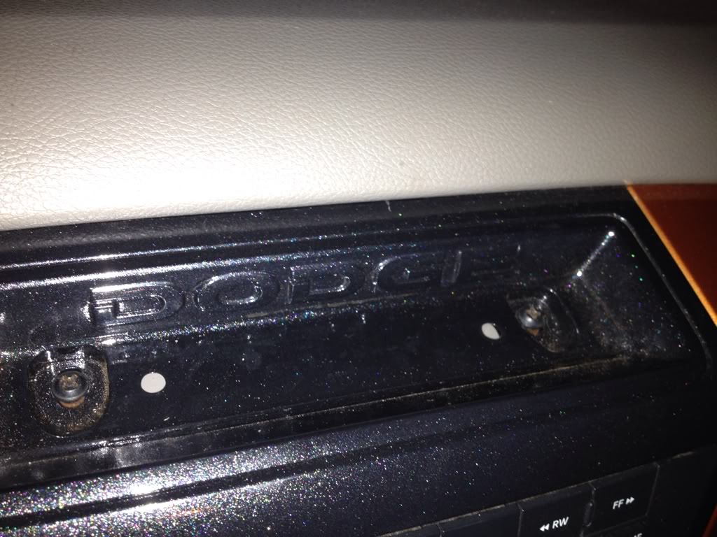

remove the rubber plate under the dodge logo. there are 2 screws there. then the panel just pops off and 4 7mm screws hold in the radio
top

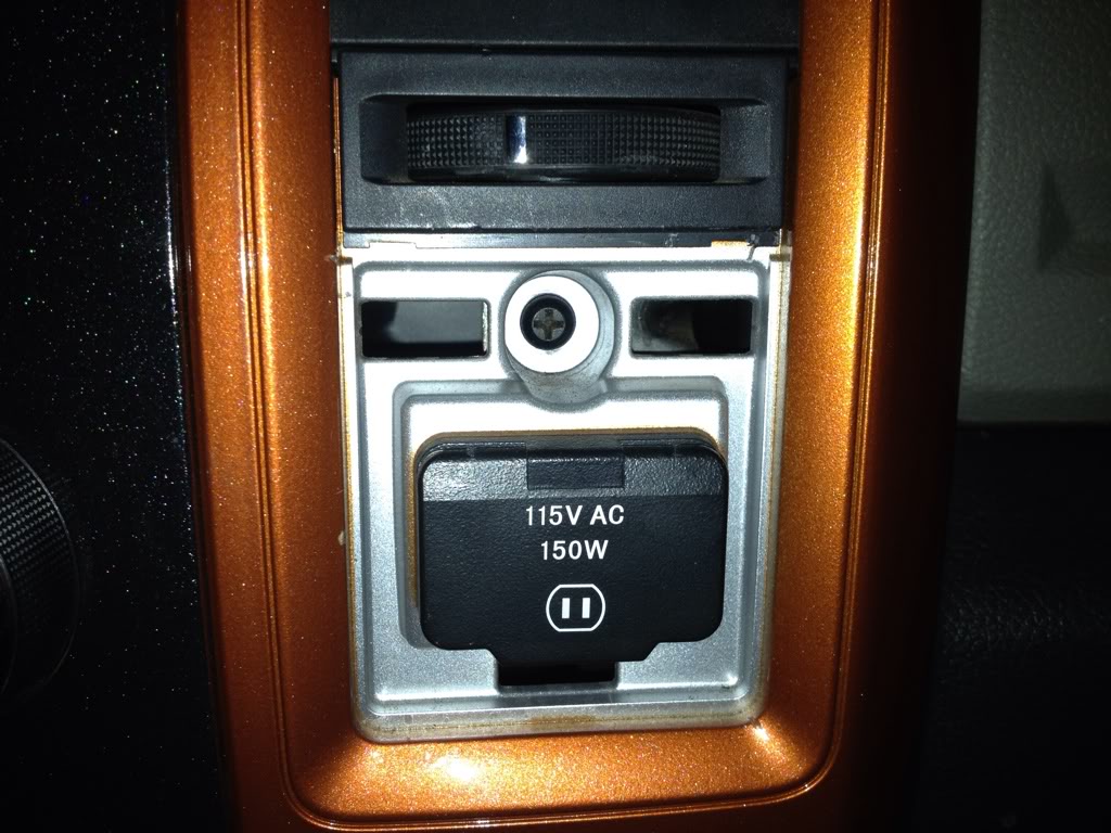

and near inverter if you have one

pics added to help you

Fantastic! Thanks Cmerritt84, appreciate the pics, no inverter, but nice to see what is involved, Thanks,

then you should just have to undo the top 2 screws and just pull it off. the whole panel has clips holding it on. theyre tight on there. get under a corner and work your way around them. may have to move gear shift to D position to get it off. and by the way its torx screws that hold that on. i replaced mine with phillips
