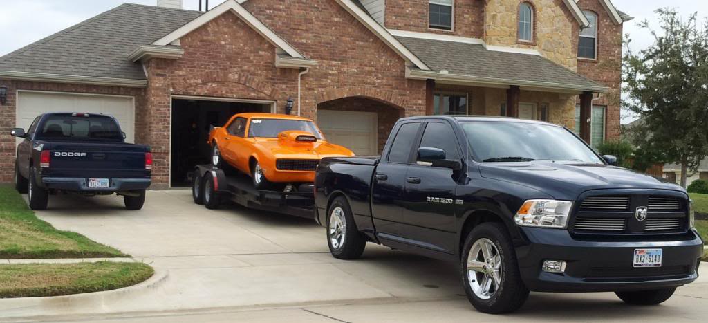

The new truck sits on the bump stops and it was okay for a few weekends but as the springs have gotten worn out, it's a mess to control. We had load assist coilover's on the third gen, but we cant find any for the 4th gen. Do any cross over from another year/truck that we can put in? Can't find any firestone airbags, either.
The camaro is 2975 pounds, 52%/48% back. We can go back about 6" further on the trailer and that's it. We're back 8" from where we used to have it on the old truck (second pic).

Sitting unloaded* (300 pounds of race equip under the tonneau) the trailer hitch height is the same on both trucks.
Putting the trailer on drops the new truck about half an inch, didn't drop the old truck even w/o the assists
With the car loaded where we used to put it, new truck sits on the bumpstops. 8" back where we keep it now, there's about 1/4" of room. I think the old truck had a little more room than that with the assists.
The car is 52% front (1547) and 48% back (1428) on our intercomps. We havent measured tongue weight.

I'd check the tounge weight and then consider a load leveling hitch. There is no way that you should be on the bump stops unless you have over 1000lbs on the ball. If you find that the tounge weight is in the reasonable range for that load (500-700) then you have something odd going on with your rear springs. If you are over 500 or 600lbs on the ball then you are exceeding the hitch rating without a WD hitch anyways.

6 inches back might make a big tounge weight difference. I would reccomemd a weight distrubuting hitch, as others have stated, as well as either air bags or something more solid like timbren.
I haul my 24' enclosed with my 09 1500 crew (should have a lot more tongue weight then your setup) and started with firestone airbags and WD hitch, eventually replaced airbags with Timbren SES so i didnt have to play with air all the time.
my trailer is probably to much for this truck, but a setup like yours shouldnt put it on the ground that bad even without suspension assistance. make sure your hitch height is correct as well.to much drop will add additional tongue weight and i'll bet your third gen sat a little higher. take it out on level ground and when the trailer is level, check where your hitch should be.
I also agree the driveway angle is probably making it worse in that picture.

Well figure a 5500W craftsmen generator, 2ft x 2ft x 3ft wide toolbox packed full, 4 ton fully hydraulic jack, 5 jack stands, 20 quarts of concrete (awning anchors), small electric air compressor, battery charger, and 25 gallons of methanol. I'd call 4-500 pounds about right. The fuel alone is 150 pounds and I know the generator and toolbox are at least another 150, each of the 4 concretes is 25 pounds each. So maybe close to 450-500.

The CG is roughly 60 inches behind the front tires/51 ahead of rear tires. So 6 inches could move the CG to closer to the trailer axles.
