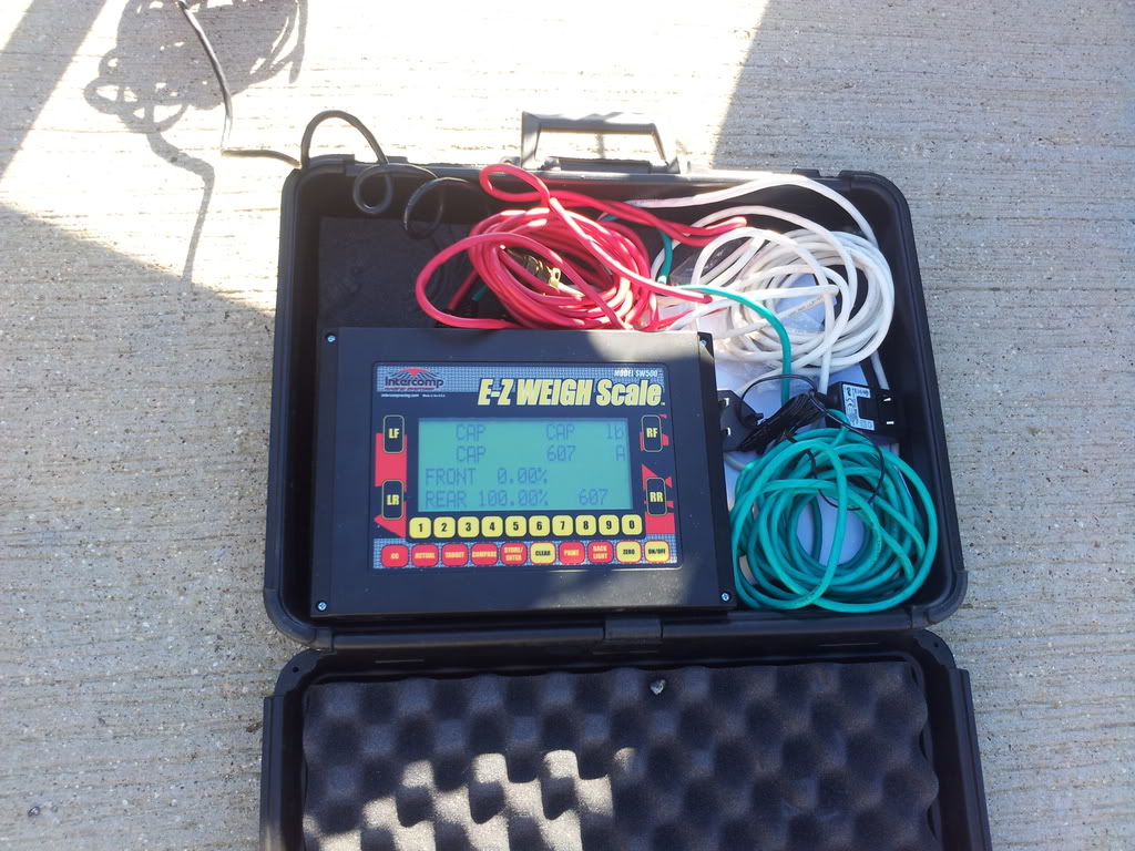

we're going to put one of our intercomp corner scales under the tongue jack tomorrow in the street and see what our tongue weight is. The hitch says 600/6,000 for standard hitch and 1,000/10,000 for a WD hitch. We have the old WD hitch from our long race rig we sold years ago, probably set for the wrong ride height but it's worth throwing on there and seeing if it'll line up or be anywhere close.

Old Oct 27, 2012 | 06:11 PM
magnethead's Avatar
magnethead
Joined: Feb 2005
Posts: 8,058
Likes: 184
From: Fort Worth, TX
Old Oct 27, 2012 | 06:28 PM
BigBlueEdge's Avatar
BigBlueEdge
Posts: 1,387
From: MN
I would not think 607 pounds of tongue weight should make your truck squat like that.
