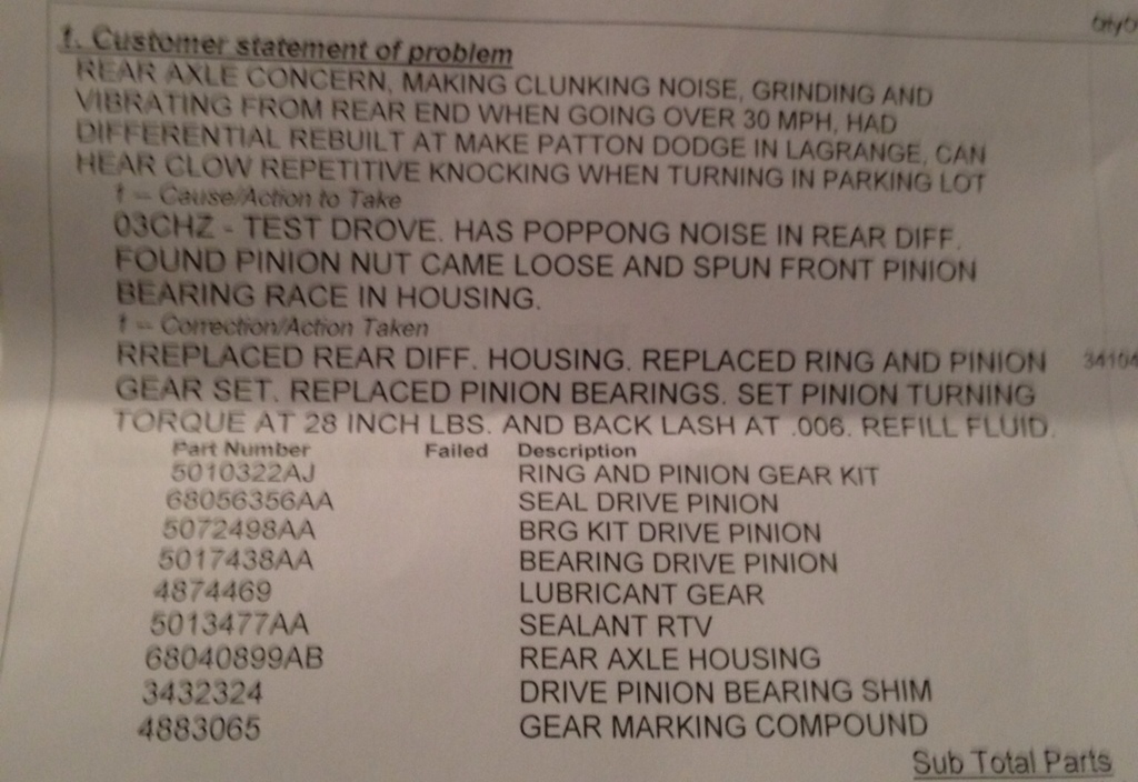

24k miles/24 months. I'm at 42000.
But the dealer called and the truck needs a complete housing. Too much clearance between the pinion bearing race and the case.

The cure
