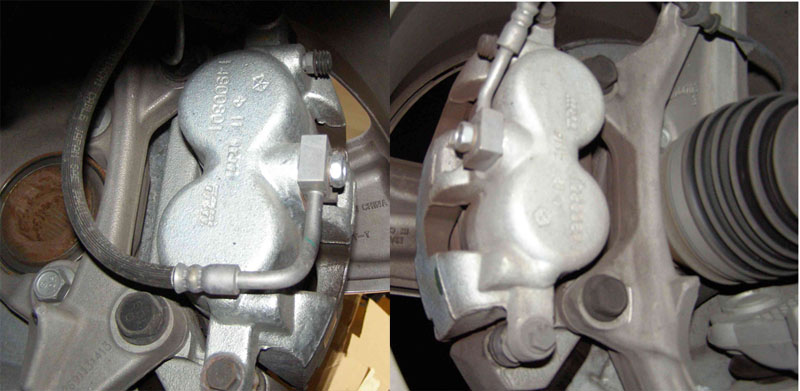

Did some initial searches. Other than rotors and brake pads, there aren't many options for the Gen 4 RAMs for SS Braided brake lines and alternative calipers.

I checked my neighbors 2012 RAM 1500 4WD. They both have the same calibers by part number but the 4WD has a different brake line. My 2WD had a longer brake line that comes into the caliper from bottom where the 4WD's brakeline was shorter and came down from the top.
My on-line search for SS brakelines for 4th Gen RAMs struck out which surprised me. I also put my hand on the brakeline when pressure was applied and there was very little swelling but the SS brake lines might help make the brake pedal firmer.
So an easy upgrade of brake pads and SS brakelines may be more difficult than first thought.

Because the stock Goodyears are not one of the better tires, the braking system should have had the capability to over power the traction of the tires causing the anti-lock braking to engage (which it did not).
I have stock calibers and it doesn't look like there is a reasonble option for an alternative. I will look into ss braided brakelines and better pads. My neighbor has a 2012 4WD Hemi. Below is a picture of a 2WD caliper from my 4.7L compared to his. Both have identical calipers by part number but the brakelines are different. The 2WD brakeline (on the left) is longer and comes from below where the 4WD (on the right) is shorter and comes from above. Not sure why they wouldn't be the same brakeline that the 4WD uses for all applications. I should be able to get some ss brakelines similar to the 4WD.
