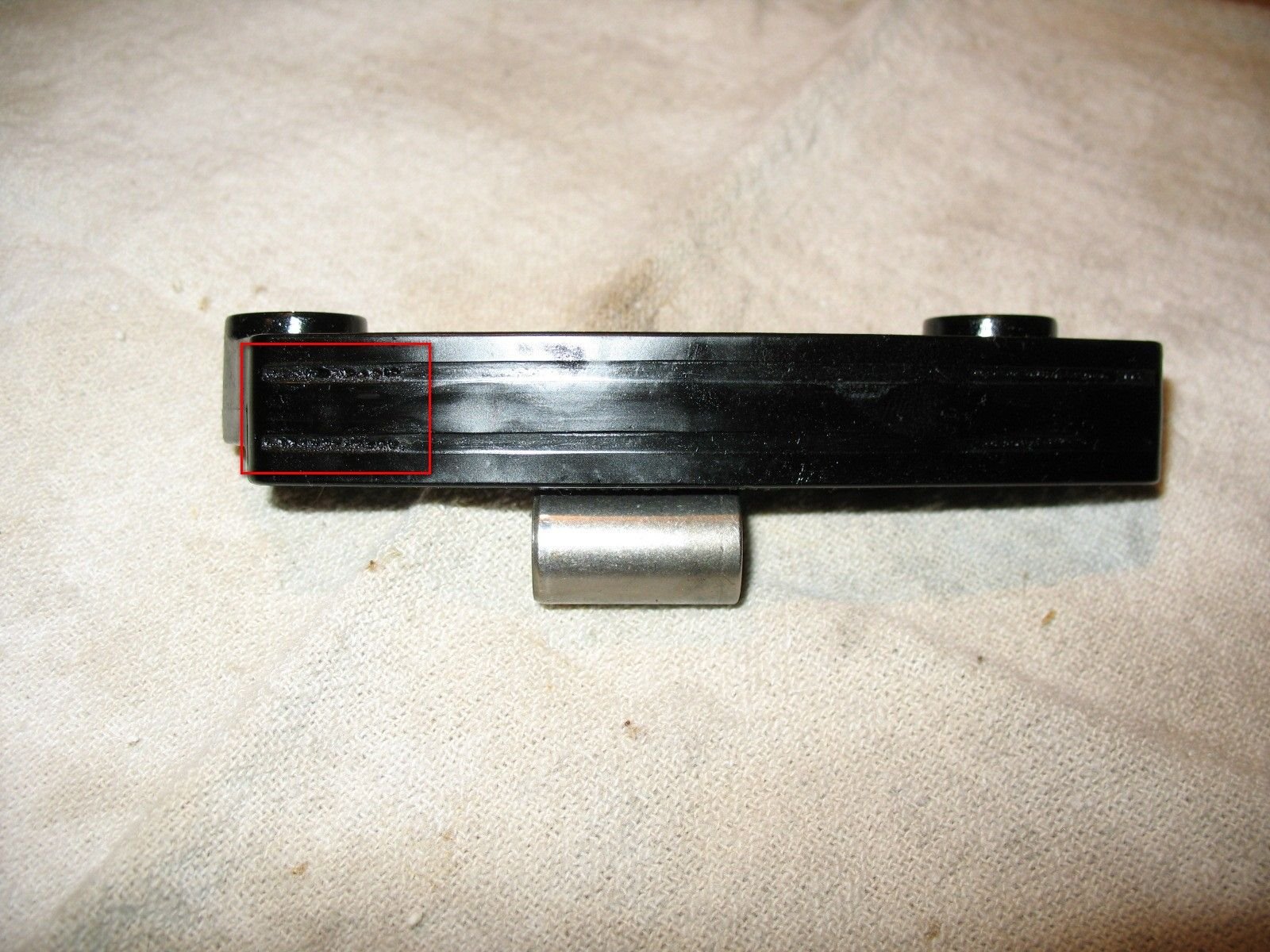

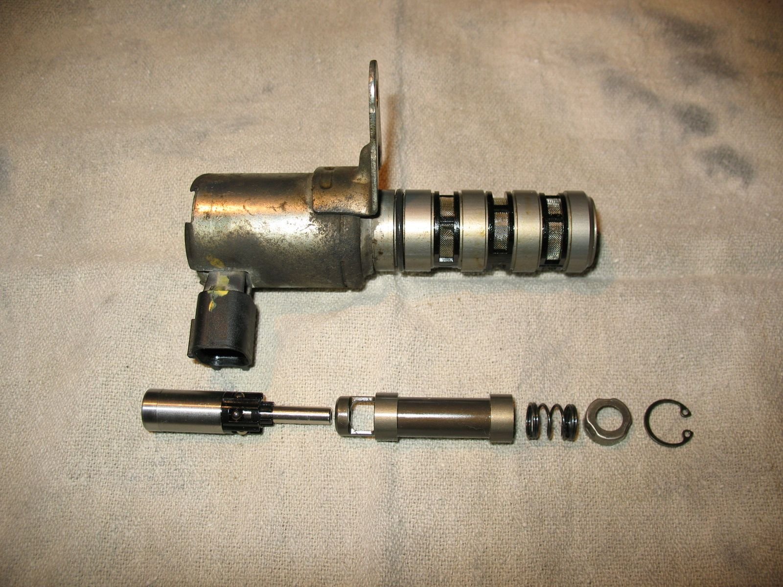

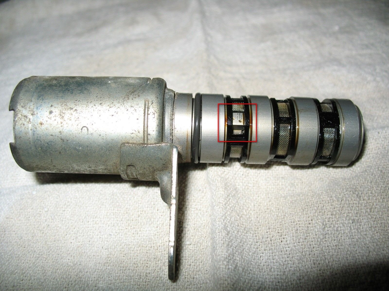

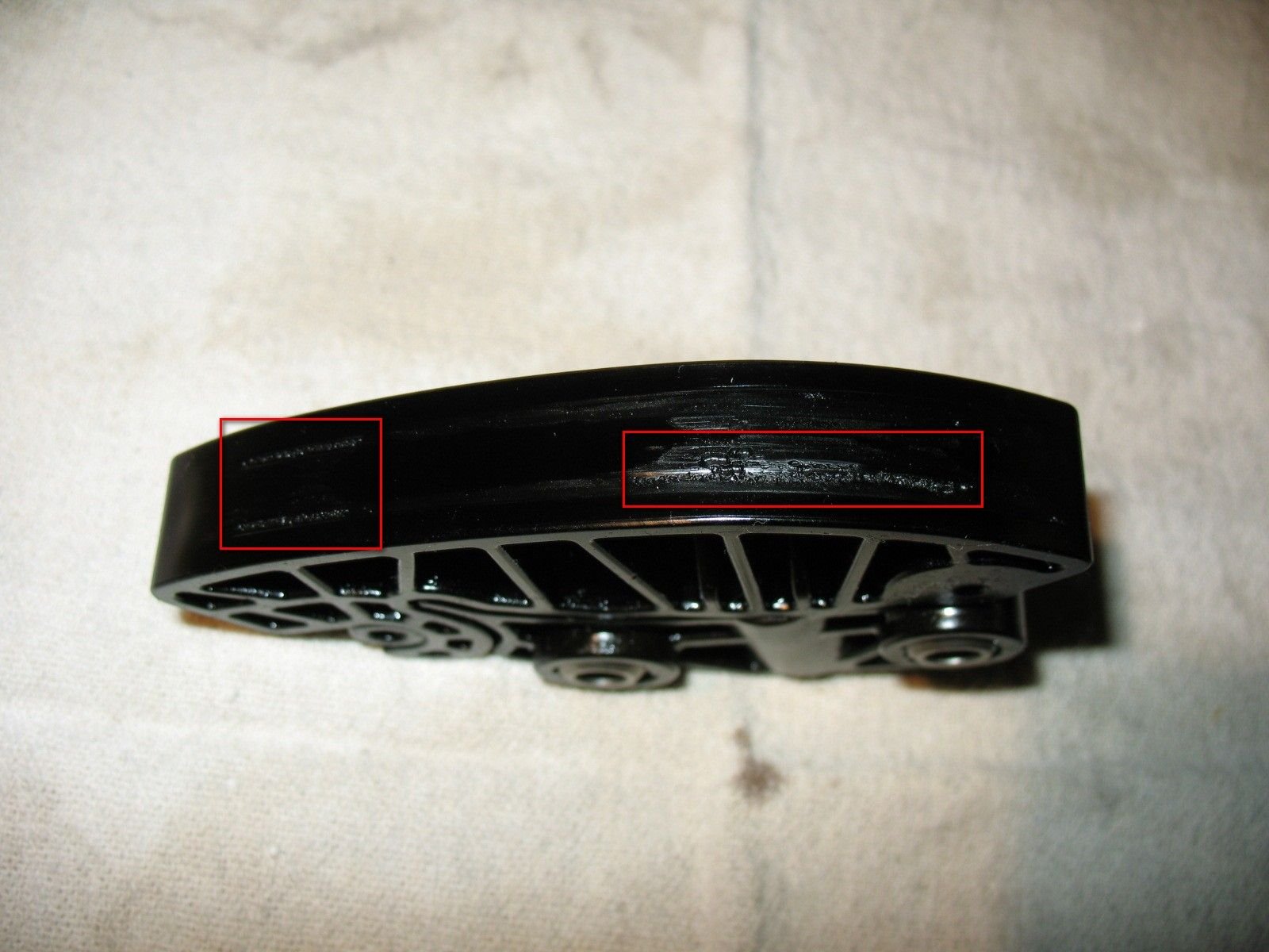

I tempered my earlier elation and rightly so. After replacing the timing chain (TC), tensioner and guide, it initially appeared (sounded) as though this issue had been cured. Then it started. That oh so familiar rattle. Very subtle at first, then ever more pronounced as the miles ticked by. Over 500 miles now since the new parts went in and we’re about back to where we started. Yep, a little disappointing but at least I no longer have to wonder/worry about what was going on under that timing chain cover. I spent countless hrs researching the TC issue for the 09 to 12 cars (cars and trucks used the same parts) and eventually had myself convinced that the components were worn well past where they ought to be. I had to know.
So what about the condition of the old parts? From the service dept’s perspective, there was nothing wrong with them. I’m certain they thought I was loco. I was surprised too. I honestly expected we would find a severely worn tensioner and guide and that was the lion’s share of the impetus for having a CJDR dealer do the work. The tensioner and guide did exhibit some wear but was considered to be far less than would otherwise be expected for an engine with over 100k km on the clock. The service dept was also surprised at how clean the TC area was. I’ll attribute that to the engine’s regular diet of M1.
Notwithstanding the tensioner and guide being considered fit for further service, the parts exhibit some rather interesting erosion (depicted below) in line with the path of TC. I would have replaced these parts based purely on this condition. The erosion is consistent with what many of the car folks found and prompts me to wonder if the base material for the early tensioner and guide was a factor in the failures associated with the Challengers, Chargers and 300s. The latest version of the tensioner (53022115AH) appears physically similar to prior units but I suspect the material has changed. The latest guide (4893429AA) was redesigned (aluminum alloy with a shoe) and bears little resemblance to its predecessor except in that it’s a TC guide.
While researching the TC issue and pondering the interaction of the cam phaser, I happened onto some information relating to failures associated with the early VCT oil control valves (OCV). Apparently the oil filter screens on the retard and advance ports of the OCV were failing and in some cases pieces of screen were getting into the valve and compromising its operation. This would typically result in a camshaft out of phase and result in associated DTCs (P0016, P000B) being set. CJDR issued a Star Case (S1118000063) early in 2012 to remove the fwd and aft screens from new OCVs when replacement was required. Shortly thereafter, a redesigned OCV, eliminated the screens, was released into service. Yep, although I’ve never seen those DTCs on the truck, I’m thinking that I’d like to get that beastie out of the engine too. Of course this would add considerably to the bill because the OCV is hiding under the intake plenum. Nevertheless, bit the bullet on that and glad I did. The image below depicts a section of missing screen and there was a collapsed section on the other side (visible in second image). Put some e-power to the valve and it appears to function just fine. Disassembled the valve and could find no damage that could be associated with the missing screen. So where did that junk end up? The oil filter, I hope…

Hi Keith,
There are two of those oil control solenoids under the intake manifold. Did they replace both?
I guess from your write up this work didn't resolve your problem. Replacing everything but the timing chain didn't resolve mine, either.
Dusty, I only replaced one VCT OCV because... there is only one. The other one is hiding where?
