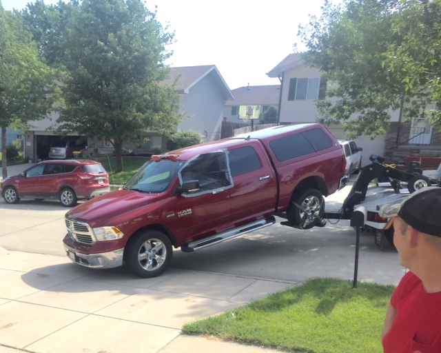

Default 2013 Ram going to Baxrter in Lincoln NE
Transmission locked in park, windows half way up. Battery good, no start, no instrument lights.
I wonder if the recall for fixing the Virus vulnerability is working. My son plays music over USB from his I-Phone.
It is outside dealers maintenance yard. I wonder how they are going to get it inside for repairs. It is strange that he got a message to not take the transmission out of drive.
The truck has 23,000 miles and is about 70 days out of the 36K warranty. Power train warranty is still good.
I have purchased 5 Chrysler products since 2005. A 2005 Chrysler 300C, a 2010 Ram HEMI pickup (lots of rear end problems). In 2013 I got another 1500 RAM Big Horn HEMI and 8 speed transmission. Also purchased a 2014 Patriot Jeep.
I am hoping maybe FIAT Chrysler will honor the warranty for a little longer than 36 months on a low mileage RAM.
See attached picture of tow truck hauling it off for all to see.
HKS
