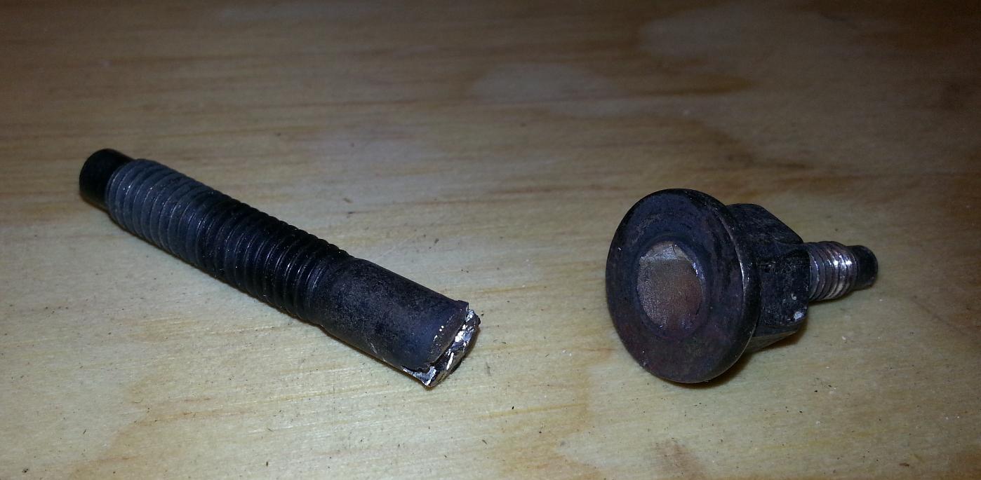

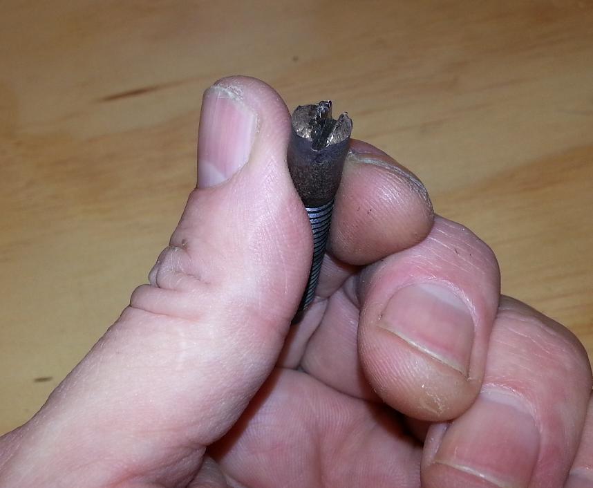

I'm the 2nd owner so I don't have the lifetime powertrain warranty. I bought four bolts from the dealer but only one of the bolts was broken, the very back bolt on passenger side. I decided to go ahead and replace both bolts for cylinder 8.
Should I do the driver's side too, even though they're not broken?
Note that I got lucky, the bolt was sheared off at the top of the manifold, so I used my dremel to cut a notch in the bolt and it just twisted right out with a standard screwdriver:

There was actually an RRT out for replacing those. If the other side isn't broke then I wouldn't mess with them.

I'm with oldjeep, even if you replace them, it doesn't they will not snap. In my case, the dealer replaced both sides during the recall, and both sides still snapped afterwards. It's a good thing I have the lifetime warranty.

I think I'll leave the driver's side in for now. I'd really hate to break them trying to remove them. Also, I torqued the bolts to spec (18 ft lbs) which really didn't feel very tight, but the ticking seems to be gone. It was getting bad first thing in the morning, so I'll know for sure tomorrow.
