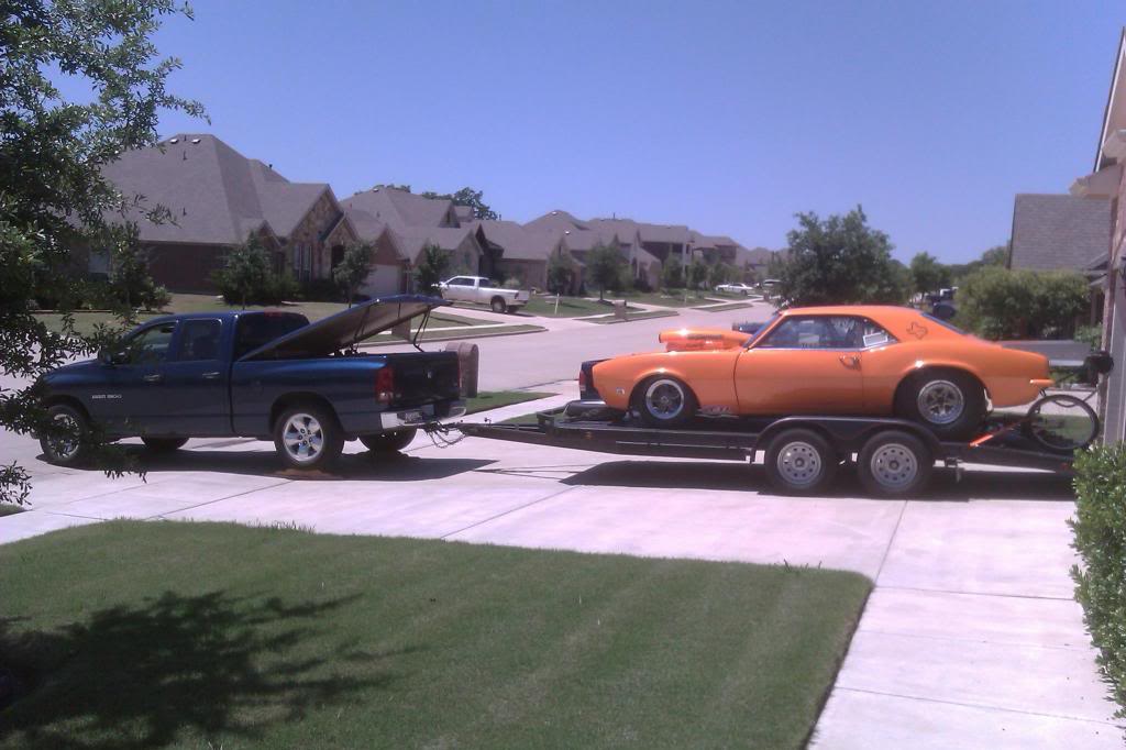

We've tried air bags, and it didn't ride well without a load and they kept coming loose of their fastenings, sent them back.
On the 3rd gen, we had spring-assist shocks (Monroe 58640), but we can't find them for a 4th gen? Comparing the 911299 no-assist 2009-2012 shock and the 58640 assist 2002-2008 shock, mounts are the same, dimensions are the same, so why wouldn't the shock fit? Because the spring rate is stiffer than the factory rate, and it'd put too much weight on the shock bodies? Each spring is 60#, so the pair would be 120 pounds per inch of compression. I would think the stock coils to be something like 250-300 pounds per inch, each.
Our neighbor pulls a tag RV with more tongue weight as our rig but with a weight distributing hitch, and we just put spring rubbers on his to see if they will help. If they do, we may put them on ours. Our tongue weight is exactly 607 pounds (scaled it under the jack, unhooked from truck) plus about 400 pounds of equipment in the bed (3200 watt generator, toolbox, 40 gallons of fuel, ect).
We got the truck last fall, and it's gotten lower and lower, like the coils are just giving out. Is there maybe a heavier compatible coil, like a coil off a 2500/3500 front end or something?

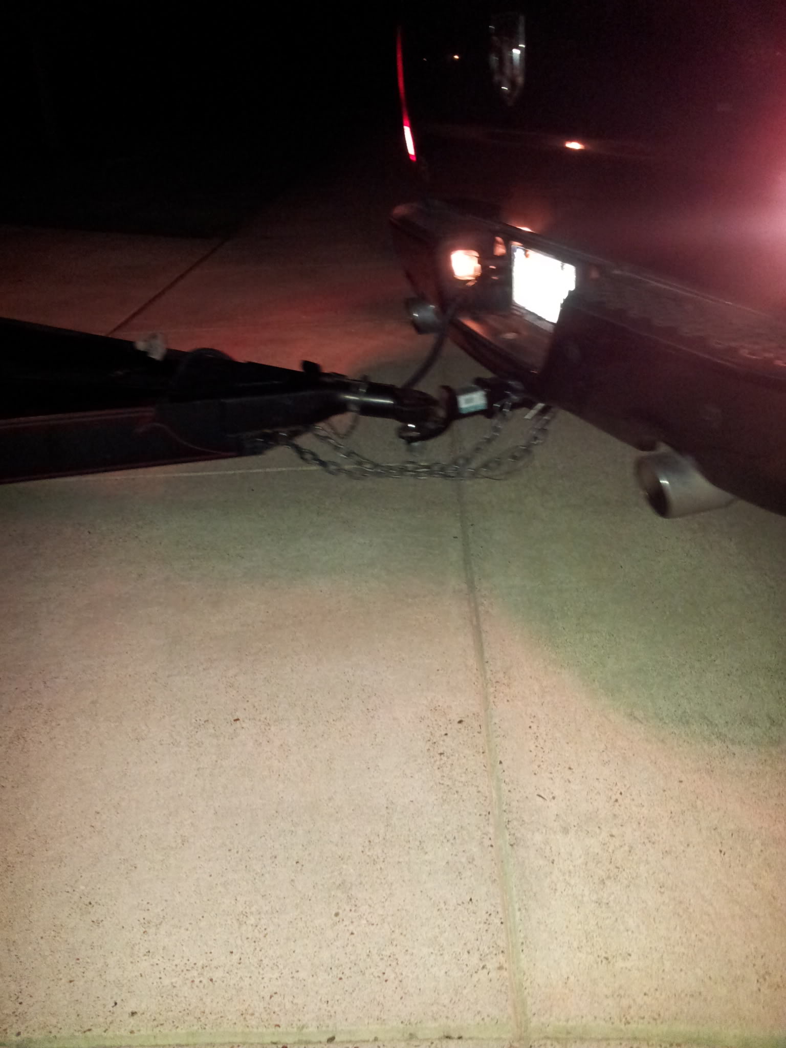

We unloaded last night, and the hitch damn near scraped the sidewalk.
The trailer is a basic 22ft dovetail, with a tonguebox for the winch. Weighs probably 2200. The camaro is 2750 without driver and we park the front axle centerline 3 feet back on the deck so the rear tires are right on the hump.
With the trailer unhooked and bed full of jobsite equipment (which is alot less weight than the race equipment), the front fenders are 36" and the back are 36.5". Neighbor's rear fenders (unloaded) went from 37.5 to 38.25 with the spring rubbers.
The sidewalk is about a foot higher than the road, and the garage floor is about 2 feet above the sidewalk. We use 3 layers of 2x6's under the rear axle for loading and 4 layers for unloading just to get the trailer up to a decent angle.

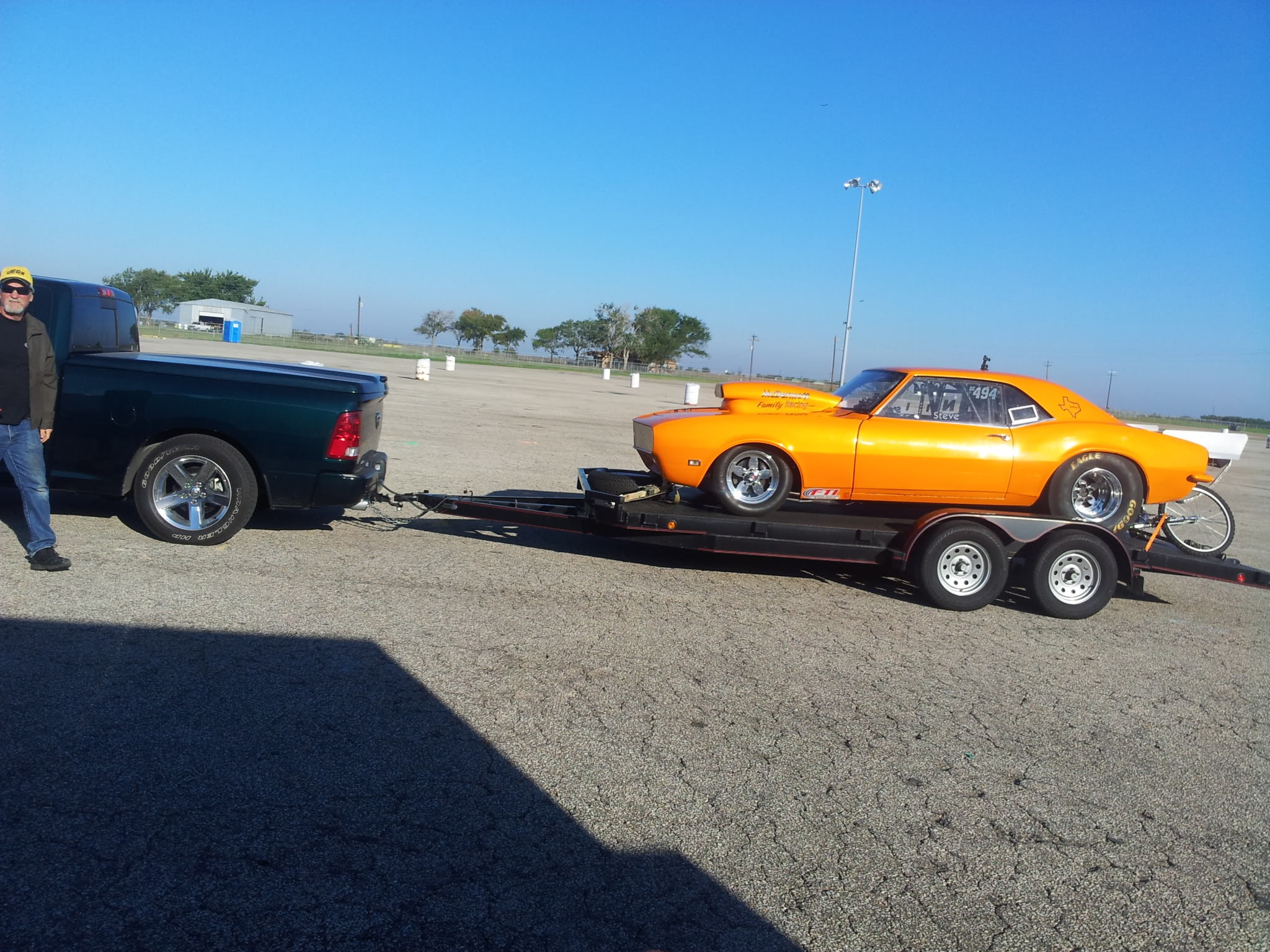

(The last picture is with the 3rd gen)

How does it sit on level ground with that trailer unloaded? Doesn't look like there is much drop to the hitch that you are showing.

The ball drops about a half inch when I hook the trailer on. It's a standard 2 down/3/4 up hitch.

What I'm asking is - is the empty trailer level when you put it on that hitch? Looks high to me, I've got to use a 4" drop on my stock Ram pulling a similar car trailer.

The deck is level unloaded, yes.
