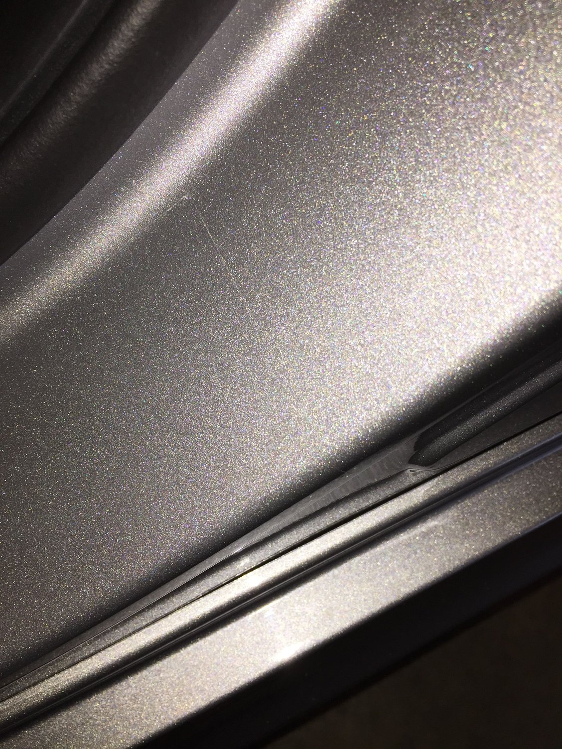

Here's one for you. Truck build = 4/11/2015. Mileage = 323. Crew cab driver's side rear corner. Was crawling under there to attach my step bars and this is what I saw.
The rust problems on these trucks seems to fall in line with the lower areas of the body, suggesting that this is because they know that most will not see it. My case looks like a pinch weld that didn't get pinched all the way. Not really sure how to fix this. I'm sure Chrysler will do nothing about it.

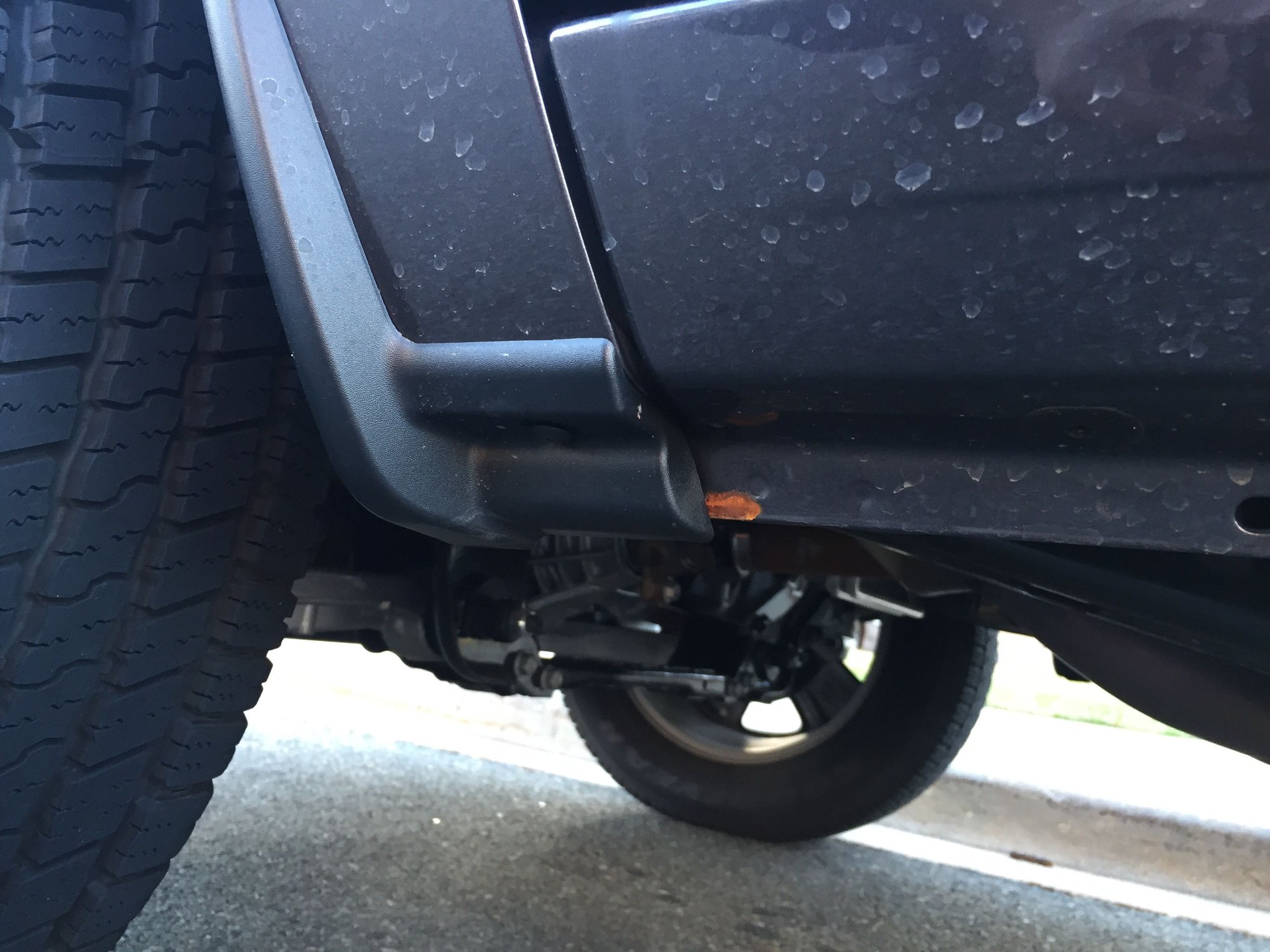

Originally Posted by Capt.fefe
i just purchased a 2015 ram 1500 special edition blacked out And I just noticed I have rust problems as well. I called the dealer and the salesman who I purchased the vehicle from told me all their vehicles are like that.
These locations you took pictures of, the driveshaft, cab mounts, and counterweight stablizer, are meant to "rust". Look up weathering steel. Its an alloy that forms a patina which acts as a protectant.
As for the pinch welds, that's a bit crazy. The paint is defective for sure. I mean they will be the spot where corrosion begins because of the stresses in the steel, but they shouldnt be showing this on a fresh truck.

Maybe the best thing to do with these pinch welds is cover them with a piece of weather striping or something to protect the paint from stone chips. It's inevitable that the paint is going to get chipped off down there. Maybe some 3M paint protection or the like. Its too bad you have to deal with this on your brand new truck, but the first thing I do when I buy a new vehicle is protect the obvious stone impact points with plastic paint protection. I buy a giant roll of it from my local sign company and go to town with it. Here are some photos off my Grand Cherokee's rocker panels. I cut some clear plastic to protect the paint from shoe scuffs and my kids backpacks. The film is barely visible unless you look very close. I also use it to protect the paint under the mud flaps on my Chevy pickup. It has held up well for the past 6 years without rubbing through.

im having the exact same issue now. Hopefull that Chrysler will do the right thing here. I've had the Ram 1500 for one week.
Originally Posted by RamRust
I purchased my Ram 1500 on Jan 30th 2015. 2 weeks ago I noticed it had a rust spot and paint flaking on the passenger side pinch weld. The dealership (Fields Chrysler Sanford Fla.) and Chrysler corp. will not repair until it becomes "a rust hole" They claim it is from a rock chip. I found several other new trucks on the lot with the same issue. I have photos and video at www.ramtruckproblems.com
I would like other potential buyers and new owners to be aware of this manufacturing defect.
I'm having the exact same pinch weld issue with a brand new Ram. Noticed it the day after purchase, about 100 miles on the truck. Have had photos taken at the dealership the following week and awaiting a response from Chrysler now. Hopeful this won't be a huge fight to cover.

The pictures Ive seen in this thread on the rust, doesn't look like a paint issue.
Even the video is the same thing.
It looks more of a trim issue. It looks like the plastic guard is wearing thru the paint, water gets in and rusts and then its flaking off. Seen it hundreds of times on anything with trim that wears into the paint, especially here, since we use lots of salt in winter.
I would agree and say your correct except the other side had a small rust spot pretty far away from the plastic. I know some may say this is from a rock chip but again, had the truck for a day before rust was noticed.
On a separate note I had some paint bubbles in the door jam as well that they are reviewing. Fun times!
