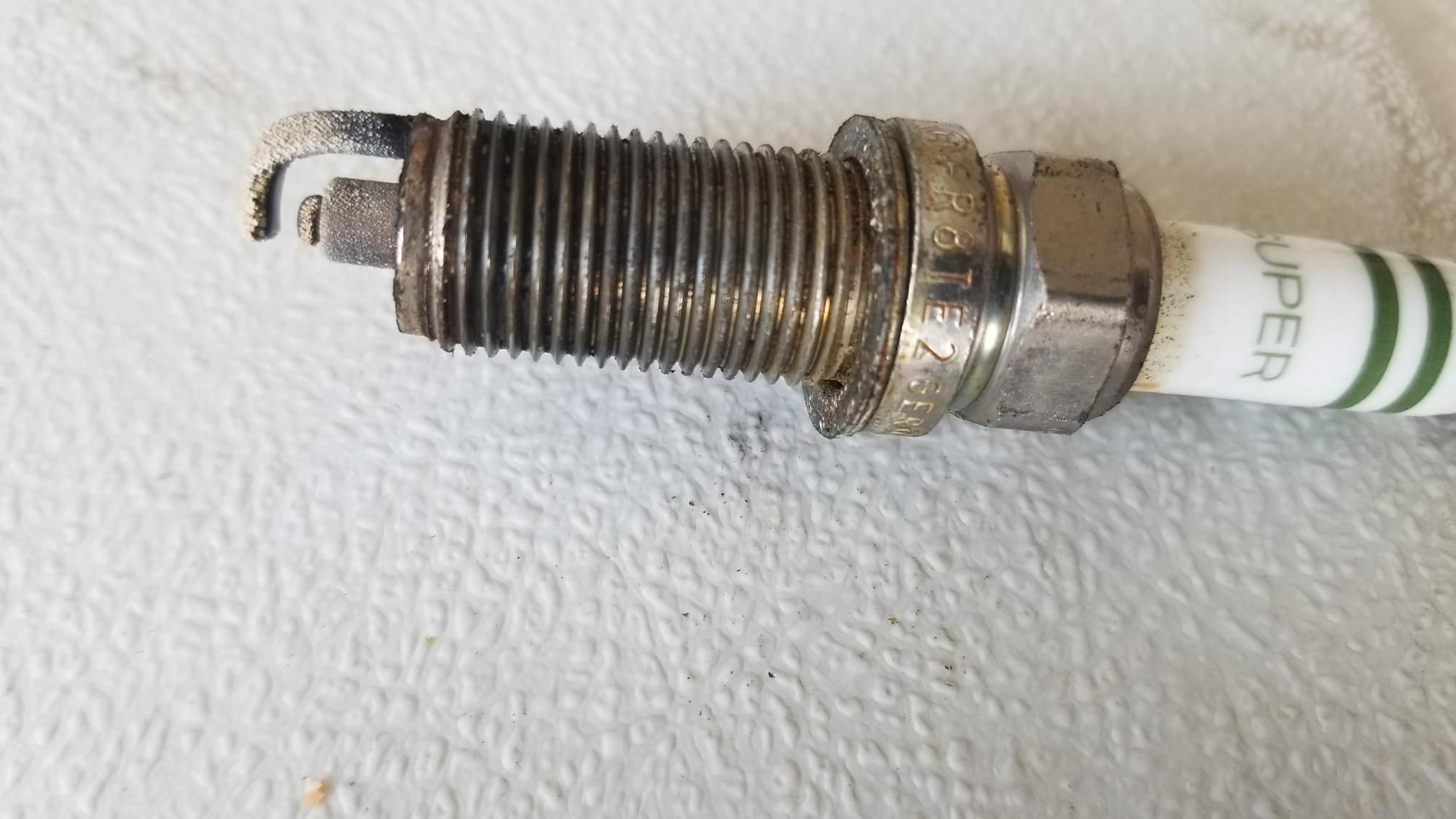

Originally Posted by Wilson01960196
I have a 2013 ram 4.7 and when I take off it has good throttle response but then it kinda drops off. It will accelerate but while doing so it'll hesitate or shudder then take off hard again. When putting it to the floor it does bad. It's almost as if it hits a wall then all the sudden it'll come alive and pull hard then hit another wall. It does not do it nearly as bad if I take off right after starting in the morning..also it will puff white smoke for a split secind occasionally on starts but not always and i havent lost and antifreeze or fluids..need some help!
I also have a 2013 Ram with the 4.7 I bought used about a year ago. I recently changed the intake (upper) 8 plugs, the wires, and cleaned the MAF (mass air flow sensor) and throttle body while I had everything opened. I went with NGK LZFR5C-11s after reading reviews/recommendations from this forum (thanks). You need an extra thin walled socket to extract these plugs. I tried 3 different sockets but had to
order the CTA 2380 (link below) which worked like a charm. You should blow out all the dirt and debris around the coils before removing them. The plug from cylinder #7 had a little ash on it and I'm not sure if it's due to being a Bosh or debris falling in when the previous owner changed them.
My truck is a lot more responsive and seems to run better overall. I would suggest cleaning the MAF first, it's cheap and easy to do at home.
Jimmy M.
https://www.jbtoolsales.com/cta-tool...ocket-10-long/
https://www.ngk.com/product.aspx?zpid=26329
