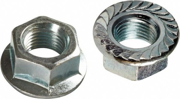

Better yet don't use bolts at all use studs! Then use fanged lock nuts to keep things tight. I have done this on many header installs with no issues.

I would think studs would be difficult to install (getting the manifold back on over them) and might be even more prone to breakage???
