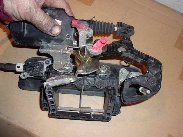

i am replacing a crashed rear gate with a salvage gate at the body shop where i work.
here is a pic of what the latch looks like on the inside of the gate.
the latch has the power lock and back up camera options.
.you will need to use a T-30 to remove the screws holding on the access cover. the latch is held on by the 2 nuts threaded to the handle studs. to remove the handle i found it easiest to remove 2 T-20 screws holding the back up camera to the handle first.

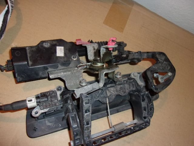

another angle. you need to use some penetrating lube on the pivot holding the bracket with the pink clips on it and the handle body. basically where you can see the spring in the top part of the handle in this pic.
