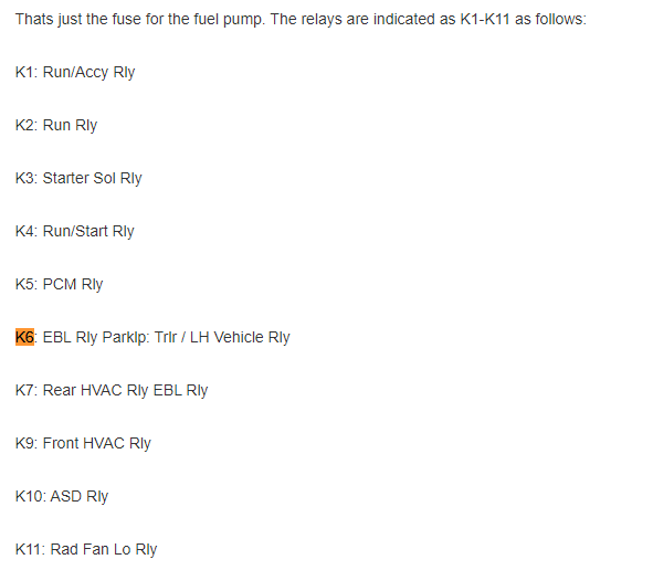

Try to keep it simple to start. Look at wire colour and tracer colour and see if you can follow it back towards fuse block and ipm. Haven't looked at my 2012 in a while. Is there a separate fuse and or relay for each headlight ??
Old Apr 28, 2020 | 12:21 AM
Gabriel Blanchet's Avatar
Gabriel Blanchet
Joined: Apr 2020
Posts: 6
Old Apr 28, 2020 | 12:22 AM
Gabriel Blanchet
Joined: Apr 2020
Posts: 6
m15,m22,m23 might be it but i don't know.

The fuses is a good start. Are you using a test light, power probe or a DVOM to test for voltage?
Old Apr 28, 2020 | 02:18 AM
Gabriel Blanchet
Joined: Apr 2020
Posts: 6
I'm using a multimeter, do you know the fuse number i should be checking because the way it's identified in the tipm is confusing me.
