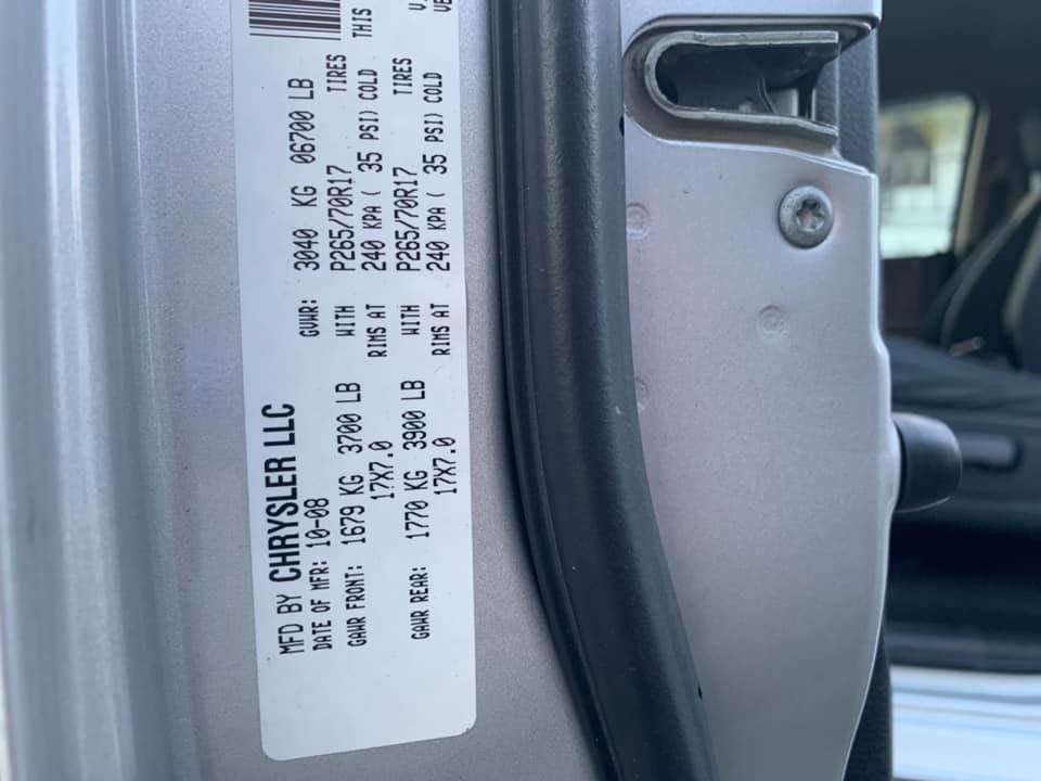

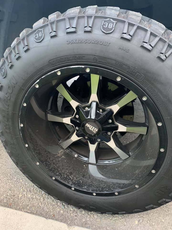

Hello! Im new to the group and new to the towing arena. It see a lot of info out there about towing. I’m in the market for a small 18 ft toy hauler with gross weight of appx 7000 lbs. By looking at the label Im assuming it’s within my limits.. Not sure if the tires offset affects this in any way. Any insight is much appreciated. Thanks!

Offset doesn't really matter over much, size, on the other hand, does..... what gears in the axles?

Hey thanks! Gear ratio is 4:10..

Ok, that's not too bad. Should be able to tow what it's rated for without a problem. The big tires will need to be aired to max pressure though, otherwise, they get kinda 'squishy', and you get the tail wagging the dog effect.
