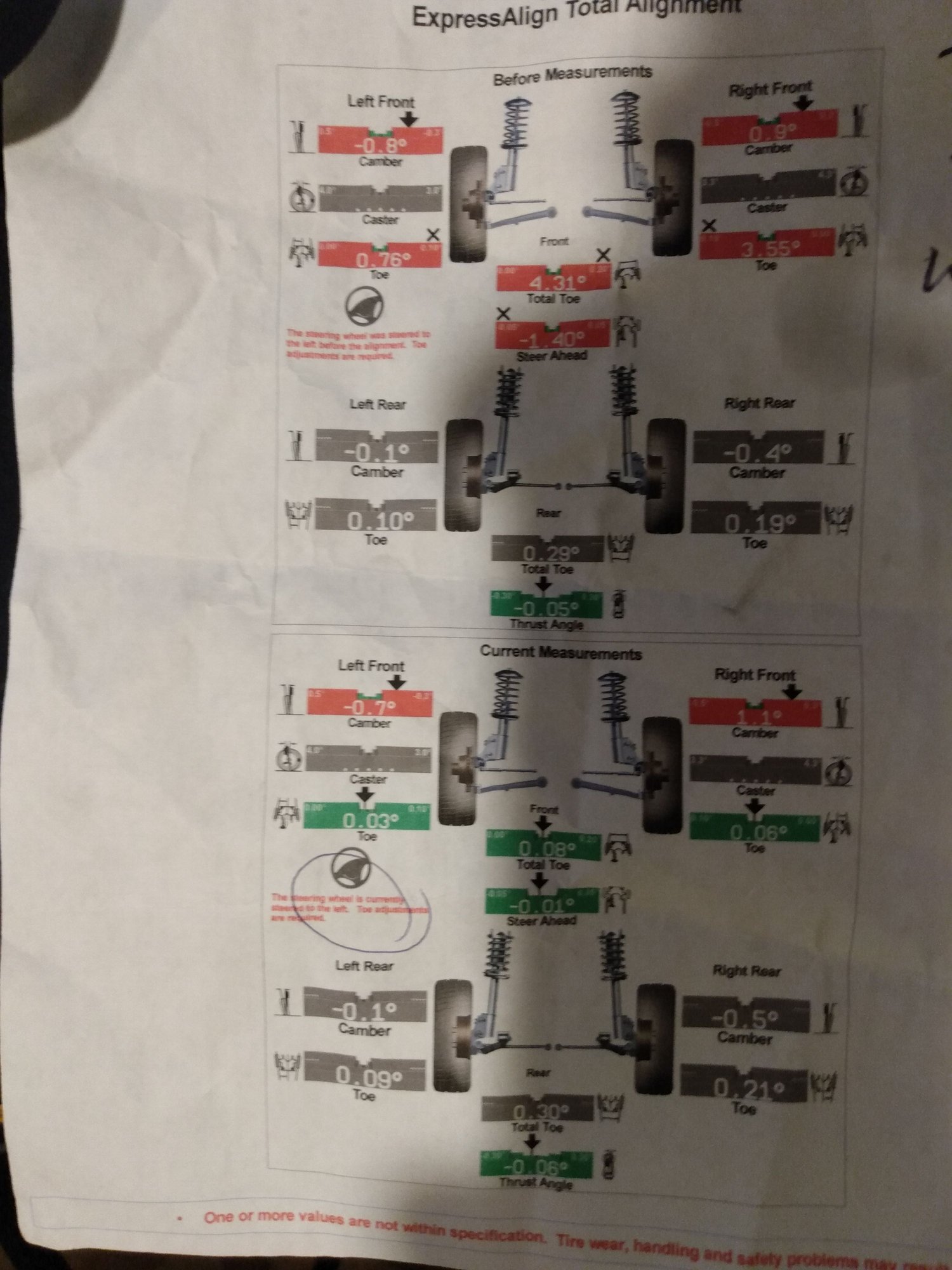

What i am here for is.... What can i do to make sure my next alignment is absolutely not gonna ruin a new set of tires? I am attaching a pic that the alignment tech gave me of the before and after alignment snapshots.
After i talked to the guy about new replacement tires, i went to a dodge dealership to ask them about alignments for my dodge truck. Because, surely a dodge dealership would be familiar with alignment issues. And he mentioned something about possibly needing camber adjusters to prevent the issue he's seeing in the picture i showed him.
Are these camber adjusters something i can install myself or does the alignment tech do it? Are these camber adjusters actually necessary? and, if they are necessary, why was my truck sold to me without them?
Anyway, the picture is attached of the alignment done from the tire shop. I would appreciate any thoughts, insight or advice on how to prevent this happening again. I apologize for the long read and thank you for taking the time to read!

Looks to me like camber is out of spec....... and they let it go like that??
Of course, they don't say just what 'spec' is either.....

Camber readings are not good, But where is the caster readings? I just see camber and Toe readings.
