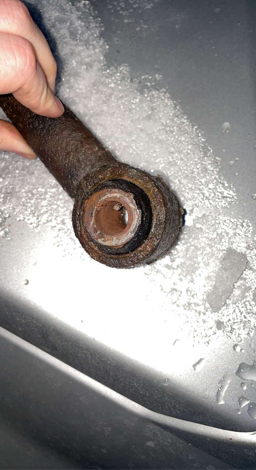

So my 2016 Ram 1500 when you get up above 55 the truck shakes left and right. If you take your hand off of the wheel you will see it turn a little left then right and will continue until you slow down to 55. It acts like death wobble but not as violent. Everything up front is tight from what I could tell. The PO did lift it, by struts it looks like. Any suggestions? Alignment is good and so is the frame I checked them myself.

UPDATE: Had my girlfriend drive and it looks like the rear axle is moving side to side. So it's the trackbar in the rear, so it was death wobble lol. Gay design I think, I miss the leaf springs lol.

Default Track Bar Installed
I installed the new track bar here was the old one.
I would say it's bad
It solved the problem!
