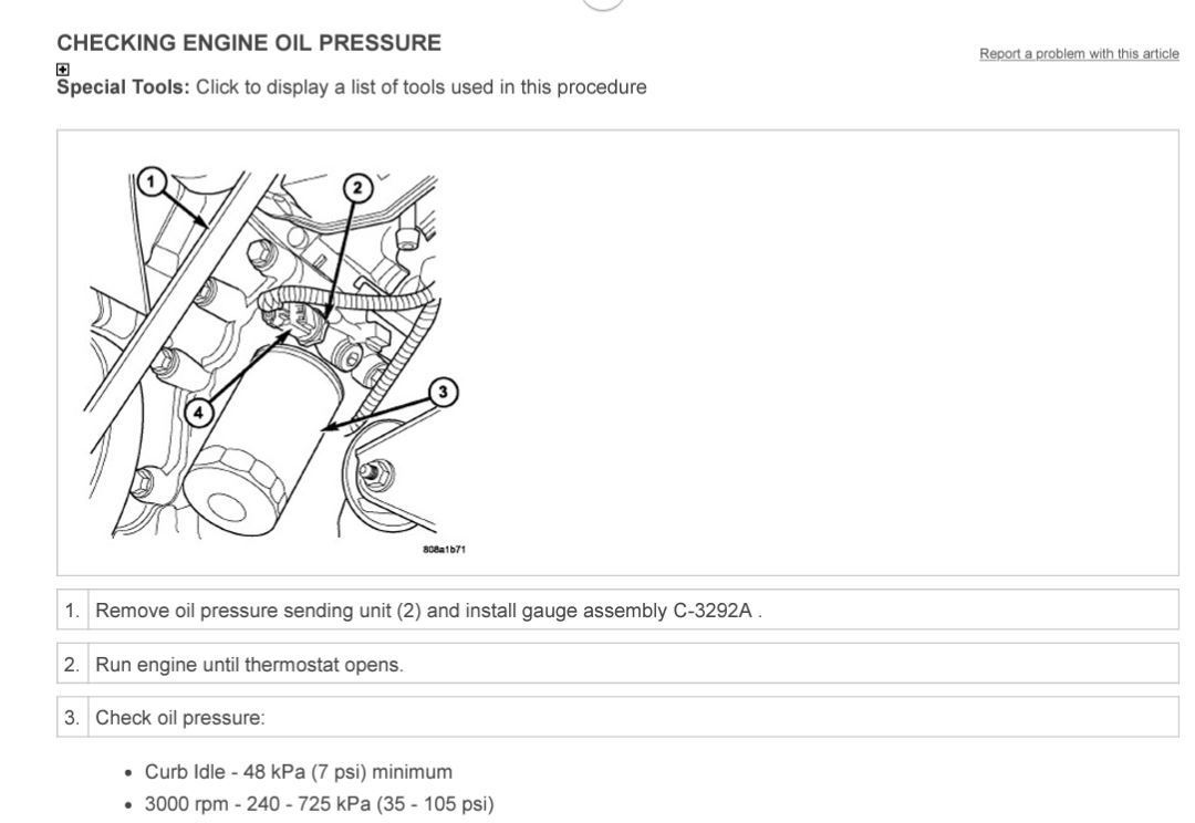

Here"s what the pdf I found says :
2002 4.7L
At Curb Idle Speed (MINI)
25 kPa (4 psi)
@ 3000 rpm
170 - 758 kPa (25 - 110 psi)
CAUTION:
If pressure is zero at curb idle, DO NOT run engine at 3000rpm.
And this PDF is for 2007 4.7L Ram:

Thank you, Site works well not a scam. I just bought it and it's the same specs than 2007 about oil pressure as I showed upper.
