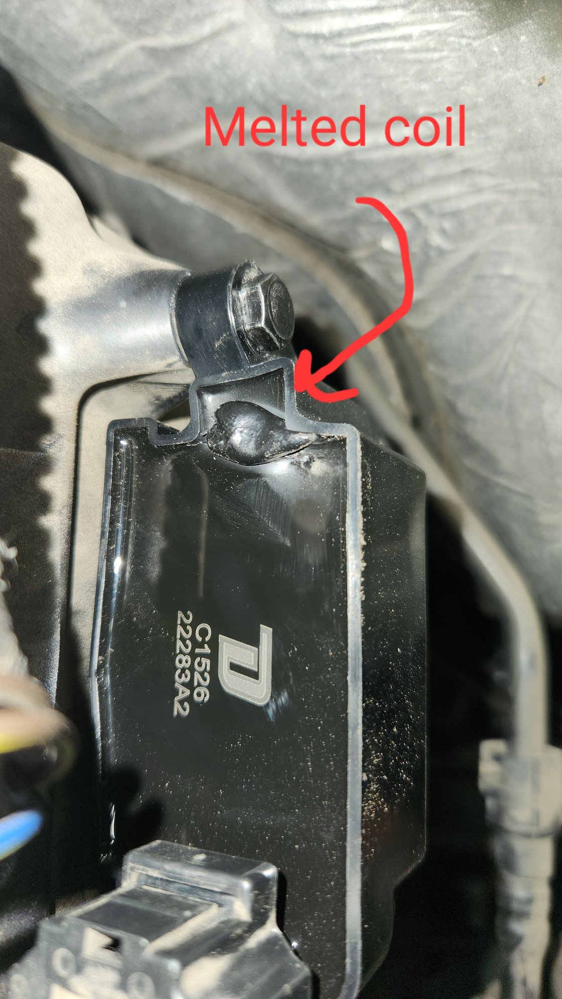

I'd also suggest you take a careful look at the connector to the coil and fuel injector for cylinder #7, especially since you mentioned the coil looked slightly melted (assuming you were referring to the connector). There's not much I can think of that would enable a bad coil or other cylinder issue to cause damage to the coil driver transistor in the the PCM (especially 2 PCMs) unless there is an intermittent connection that is causing the current draw in the circuit to spike, or some other wiring issue that allows too much current to flow through the driver transistor.

I believe I took the #3 and put it on #7 and after it didn't work I put it back but the misfire followed it so I assumed that anything I put on coil #7 was going to ruin the coil. I also put all knew coils on with the new PCM and coil #7 melted.
I did look at all the wire connectors that connect to the coils and injectors. I didn't see any visual issues that would lead me to believe there was a problem. The dodge tech also said all the wiring was good. Not sure how in depth they look though. That's really why I ended up taking it to them because I don't know enough about electrical stuff and hoped they could at least rule some things out. What might cause an intermittent connection that leads to a spike? Someone else I talked to said something similar and felt like there had to be a short circuit somewhere. I just don't have any idea where to look and with dodge telling me all the wiring was fine, I'm even more stumped...

I think you failed to upload the picture of the melted coil.

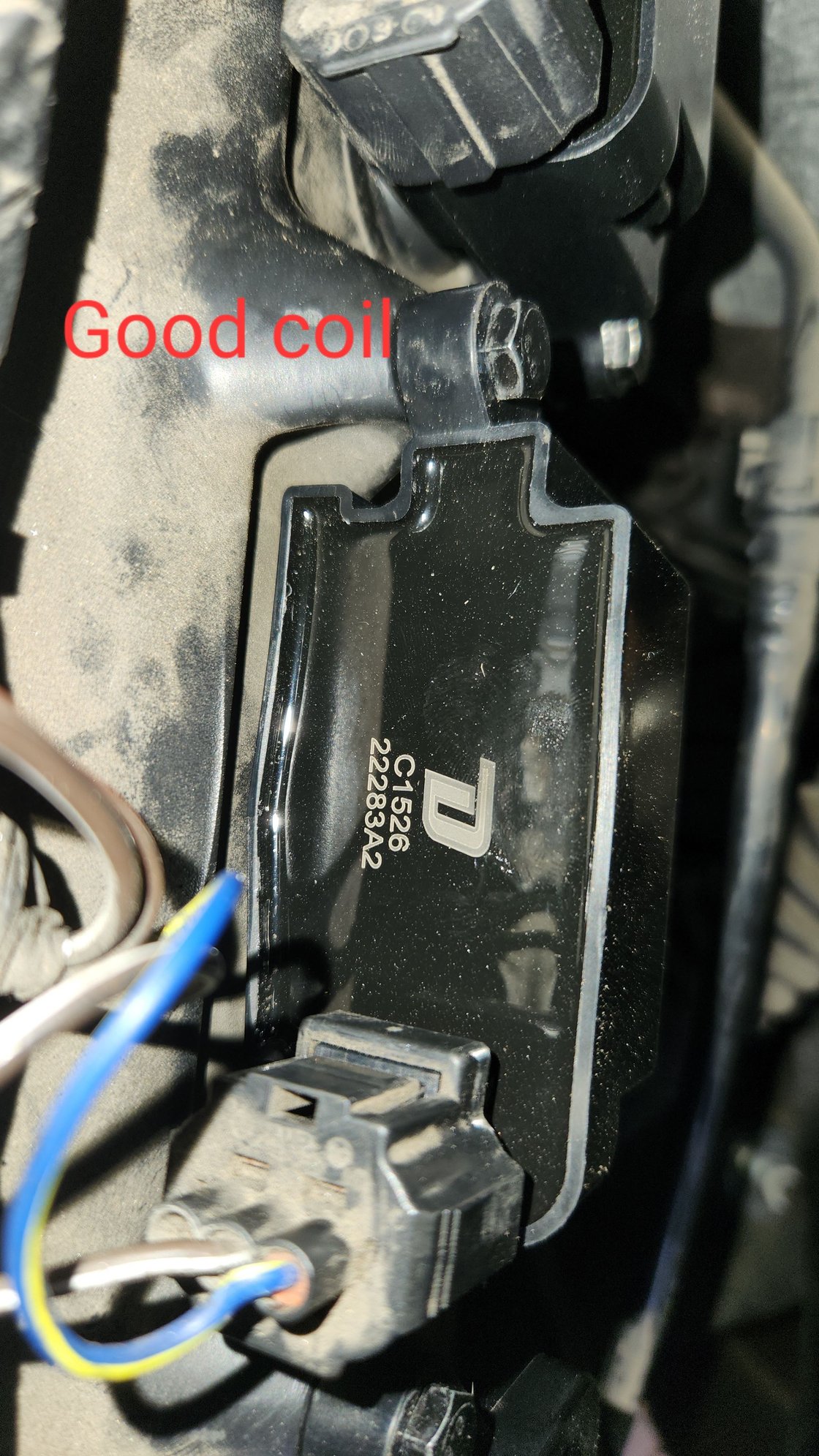

Oops, yep here's the pics!
This is the brand new coil on the #7 cylinder. Ran for less than 10 miles and then melted. This was after I got stuck at the dump.
This is another one that is not melted for reference.
