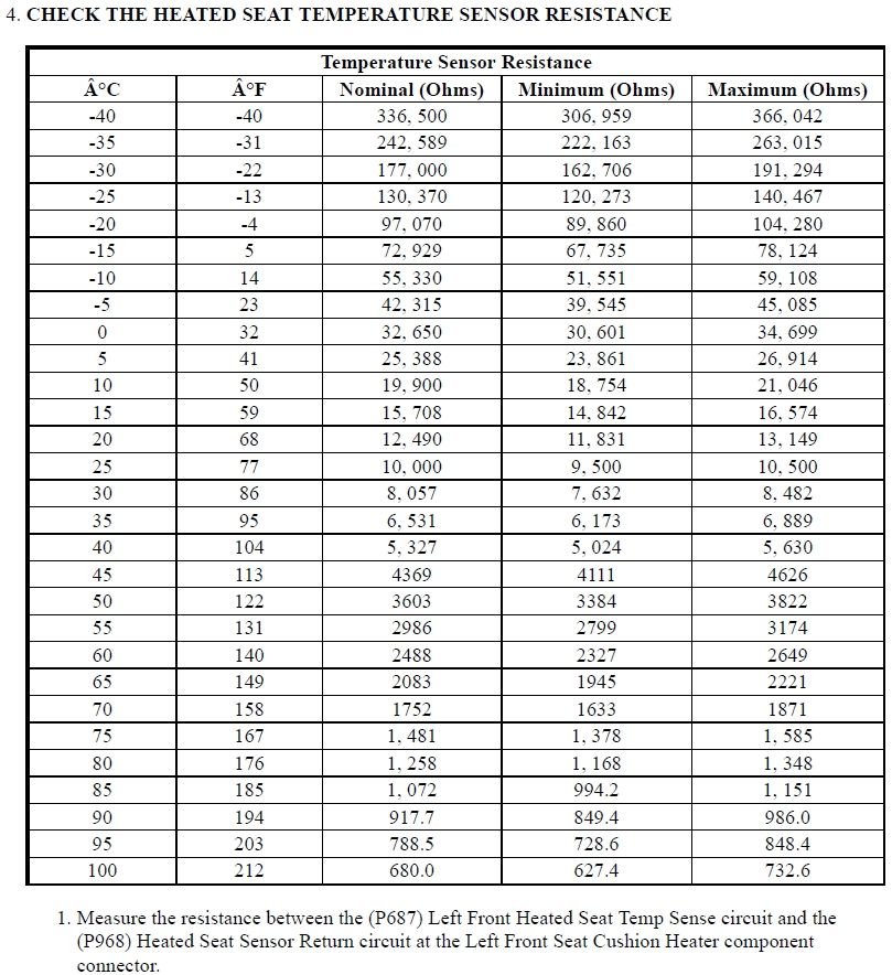

I just recently fixed a rear heated seat in my Charger that would light the switch for about 2 seconds when pressed, then turn off. The diagnostic code indicated an open thermistor. I removed the seat bottom and confirmed no reading across the wires for the thermistor. Rather than buy a whole new heated seat bottom I opted to pull the covering and installed a new 10kohm NTC thermistor that cost a whopping $0.12 ($12 for a 100 pack of assorted thermistors). Now the seat is working like it should again.

I don't remember if I pulled the code using my Autel MS906BT or through AlfaOBD. The sensor is a 10k NTC thermistor, so 10 kohm at 25 degrees C (~ room temperature). Pasted below is the resistance table.
-Rod
Dodge Charger heated seat thermistor resistance table.

The thermistor is likely embedded within the seat heater pad and not necessarily obvious or easy to see. The wiring however should be pretty easy to test if you're able to determine which color wires are for the thermistor. There's probably only a thermistor on the bottom seat, and there may be 4 wires to the seat and only two that connect to the seat back. The two wires to the seat back hopefully match the color of the two wires they plug into and two of the wires for the seat, which should make it a pretty safe bet that the other two wires are for the thermistor. If the resistance across those two wires is essentially an open circuit, then you either have a corroded connection from the water or a bad thermistor.
