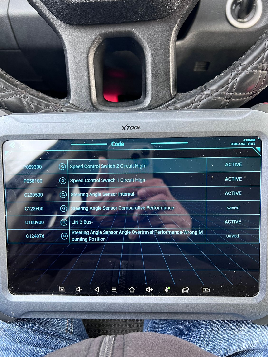

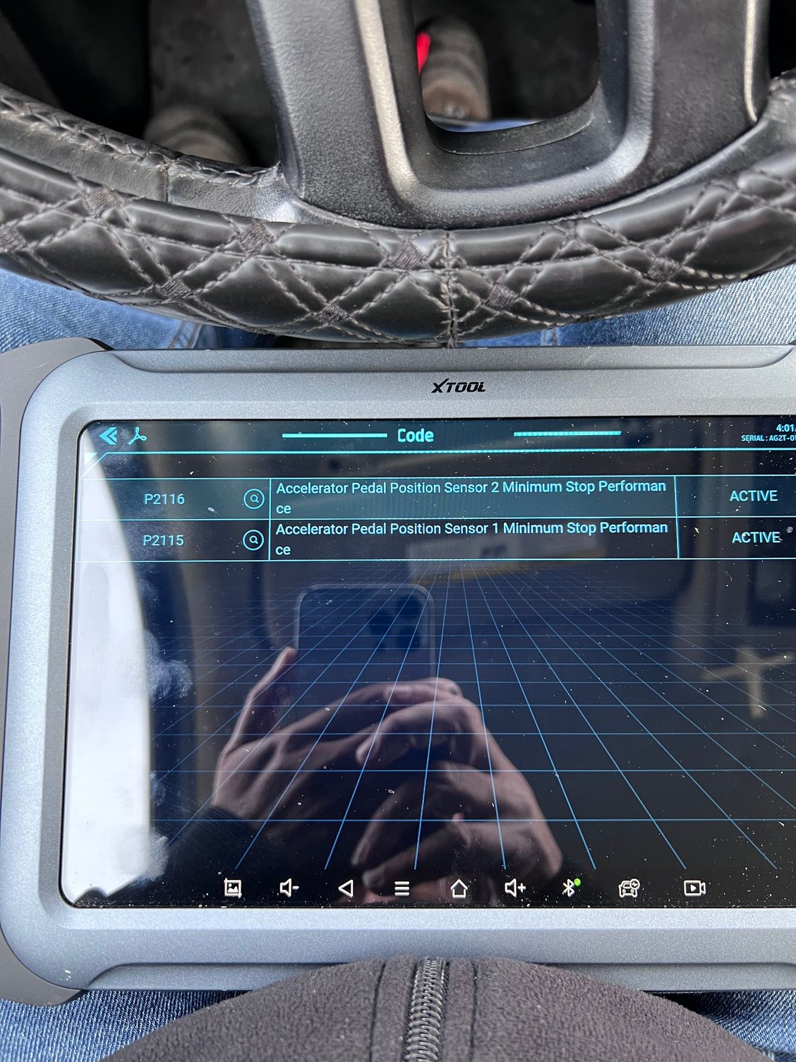

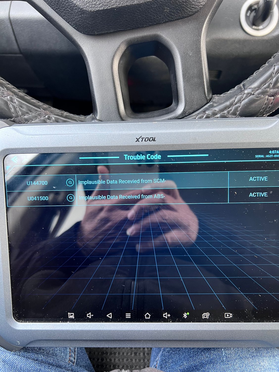

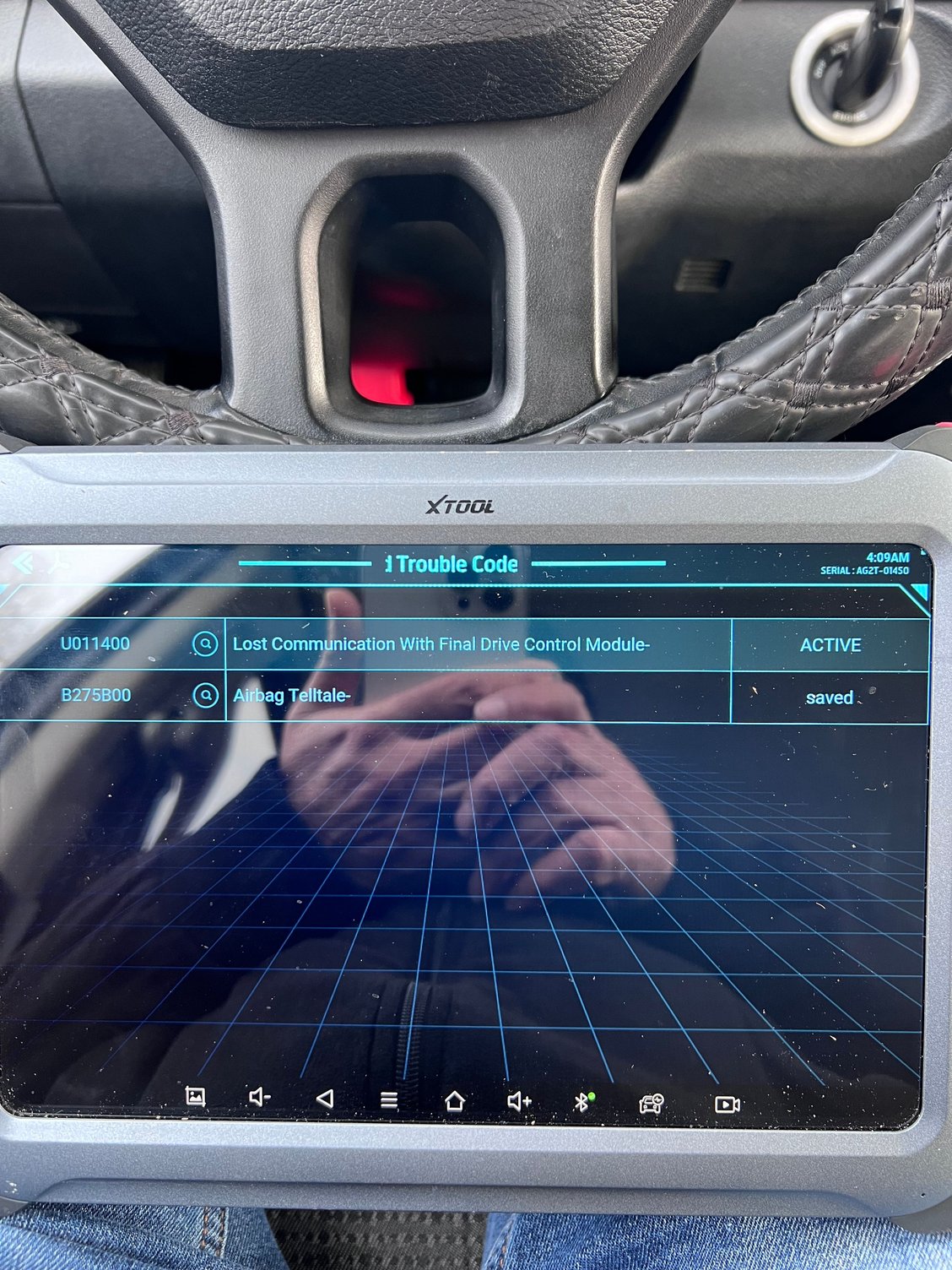

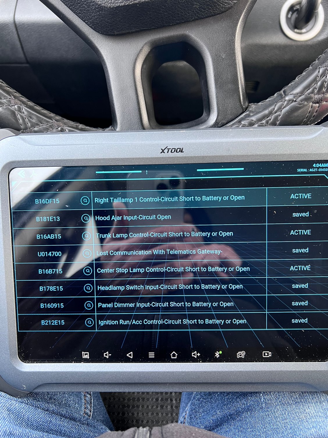

Hello sir I got the accelerator fixed and calibrated, but I still have some more issues. I have a lot of issues and codes I will attach pictures of all the codes if anybody can help thank you.

I would be real tempted to reset the computer, and start fresh....... WAY too much going on there.

I agree, you have a lot of codes showing up as stored versus active, so at a minimum clear the diagnostic codes and see what remains. Also, some of the codes shown could be related to low voltage, so make sure your battery is charged up and then clear the codes again.
-Rod
