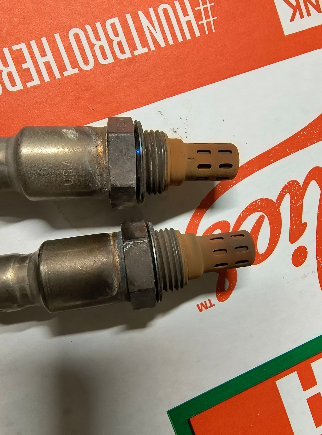

Pulled the O2's out found this situation:

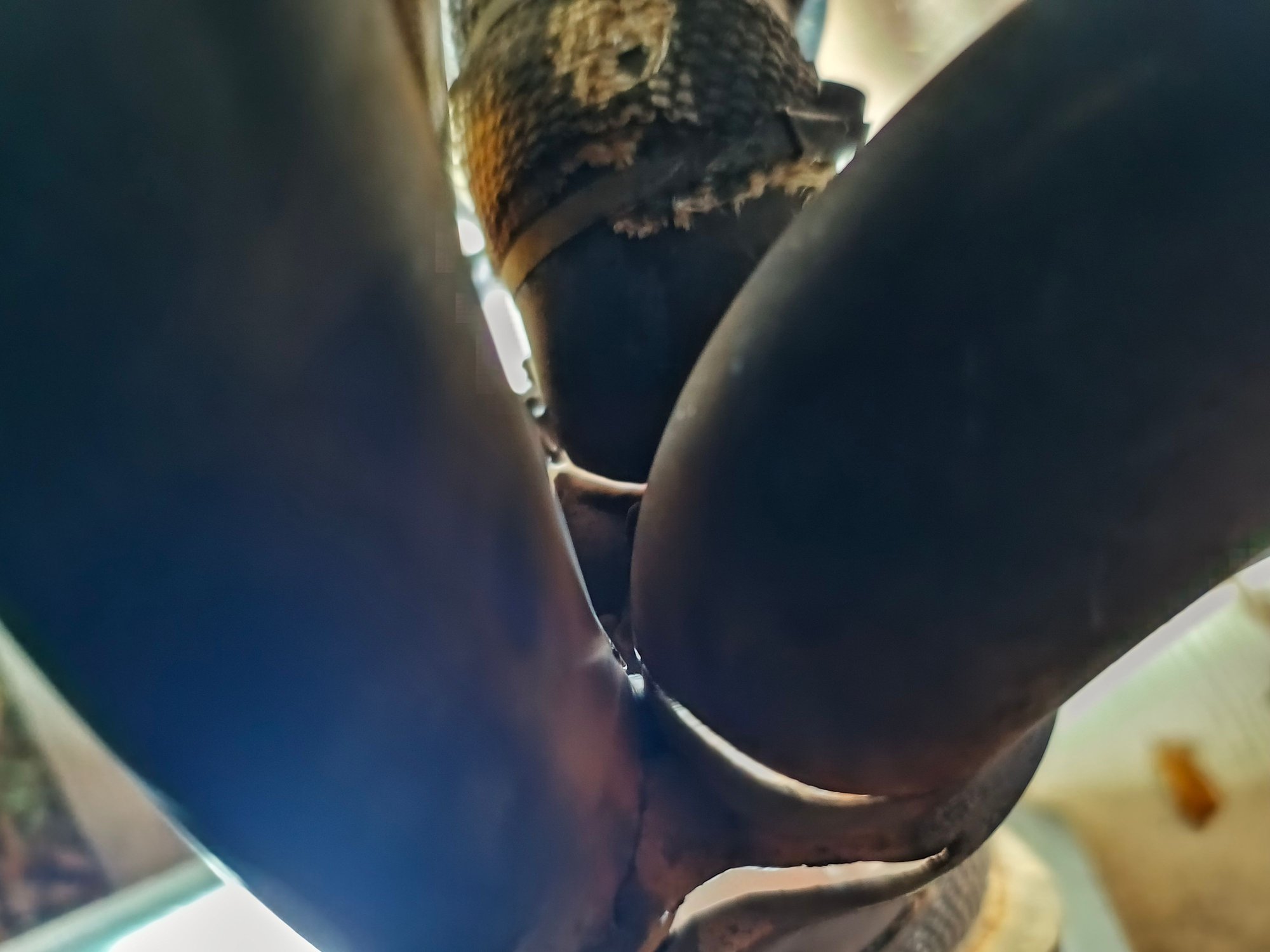

After pulling the drivers side header as it was the worst between the two, this is what I found:
I'm not an engineer, welder, certified mechanic, etc, but something tells me that is not what these are supposed to look like.
These headers are <2yrs old. They are SPELABS headers. They are trash! Supposedly they were stainless steel, I'm doubting it now, or they used the wrong SS grade.
So I'm guessing what happened is that the welds started cracking on the headers, this allowed oxygen to get sucked in and cause rusting inside the header. The fine particular rust started to coat and damage the O2's. Which in turn started throwing off the reporting values, plus the O2 being sucked in the cracks. These in turn made half the engine run lean, the other half run rich (I had both ODB codes reported). Then the lean side, drivers, burned out the spark plugs.

Ah, but, I would fully expect that you HAVE gotten to the root of the problem. Which is sometimes FAR more than half the battle.
My cheap chinesium stainless steel headers rusted out. There were sections several inches long, that were just gone..... There are various grades of SS, and the chinese fellers use the absolute worst grade, that they can still legally call 'stainless steel'.....
