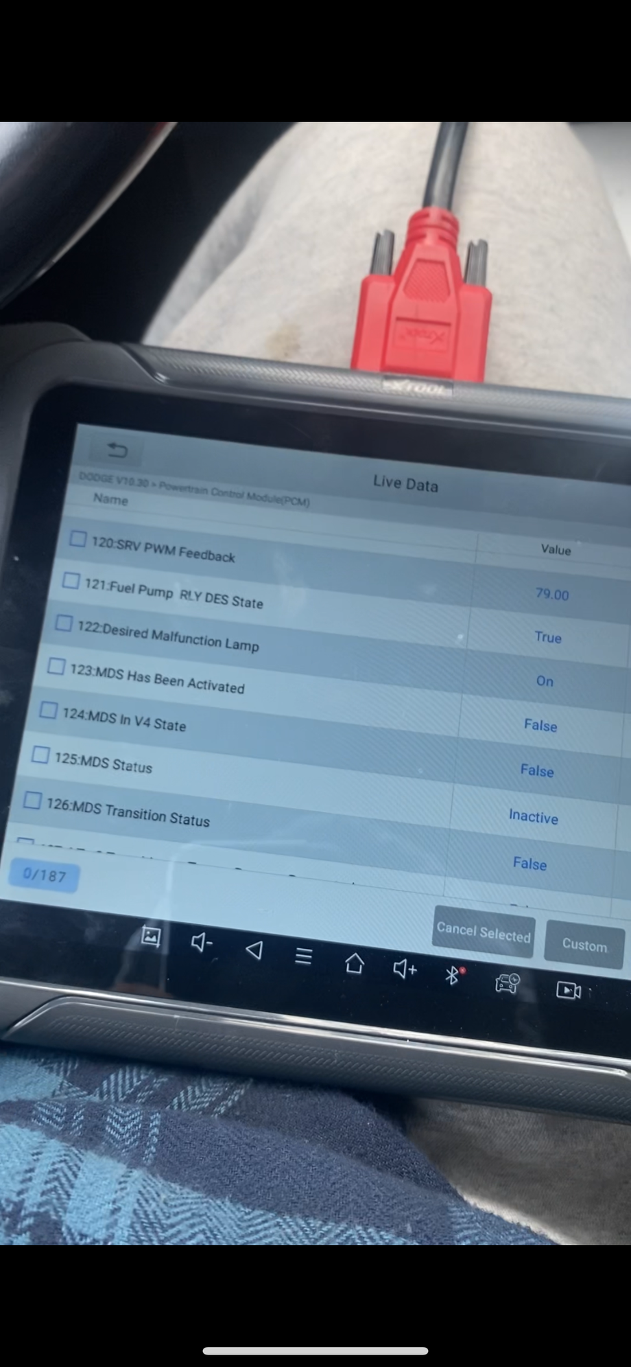

The truck starts right up, runs really great on cold start then sits at about 7-800 rpm. In reverse the truck has no issues then put it in drive and by the time it shifts to second I’m getting a multiple misfires code. I have a great scan tool and that’s all it’s telling me. Also if you turn on the truck and rev it up to about 2500 rpm’s same thing happens, engine light flashes multiple misfires… and you can feel it.

I can’t see that for whatever reason on this dodge. But I can see the mds system is not active so it’s gotta be these new lifters or the new cam

So this is an area where (and I cannot stress this enough) you truly get what you pay for. You already figured out your first mistake. You can manually activate MDS solenoids when static but the lifters won't collapse unless all required conditions are met running down the road. I've seen where the chinesium lifters don't actually function properly, MDS or not, which would explain all the misfires as rpm climbs. Any timing issues will only further compound the problem. Save your pennies, get a quality kit or buy a factory 5.7 2500 cam and new non-MDS Lifters and try again.
