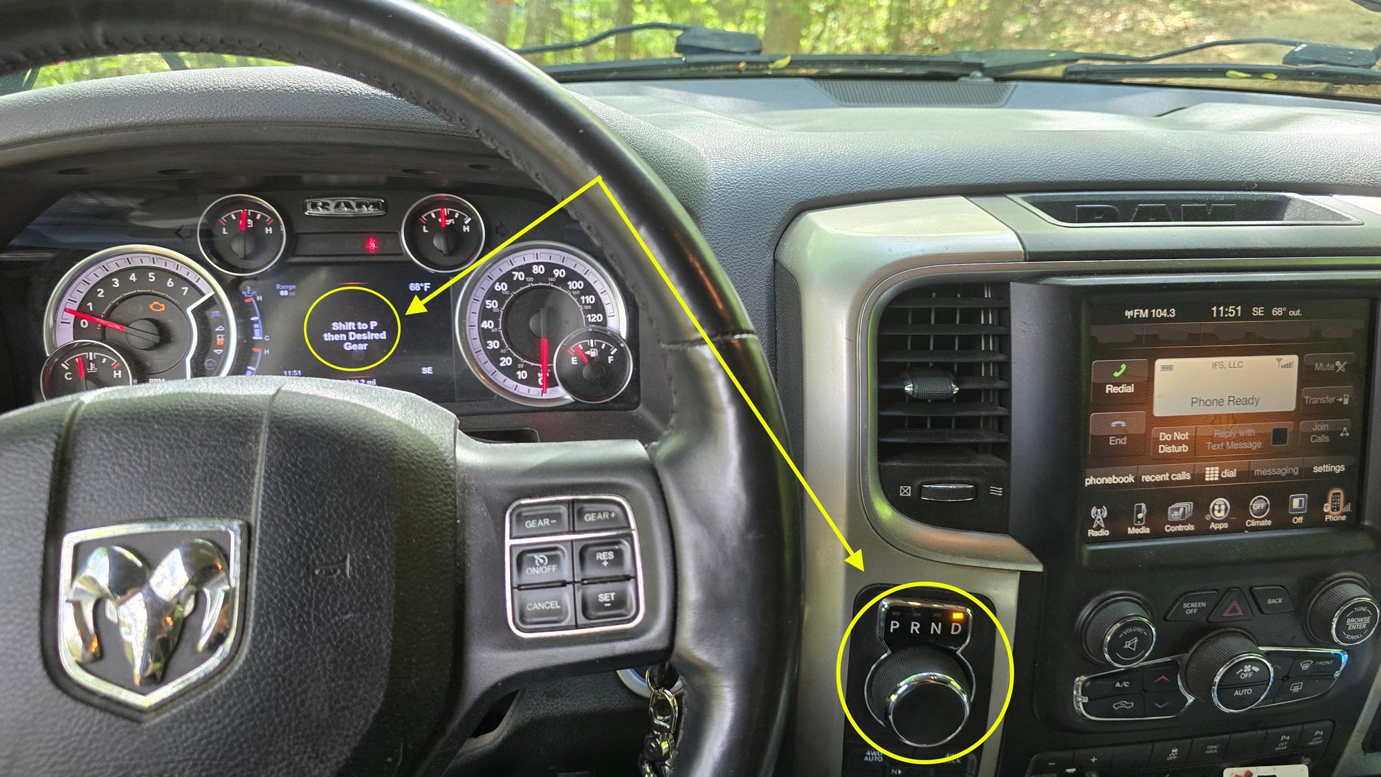

I get 500' down drive, started on an incline and truck stops moving, engine rev's high. I back down the incline and started receiving the "Shift to P then Desired Gear" notification on dash and the Drive selector LED flashing. Looked it up, thought I had a malfunctioning switch or software issue. Disconnected battery to reset 'puter, to no avail.

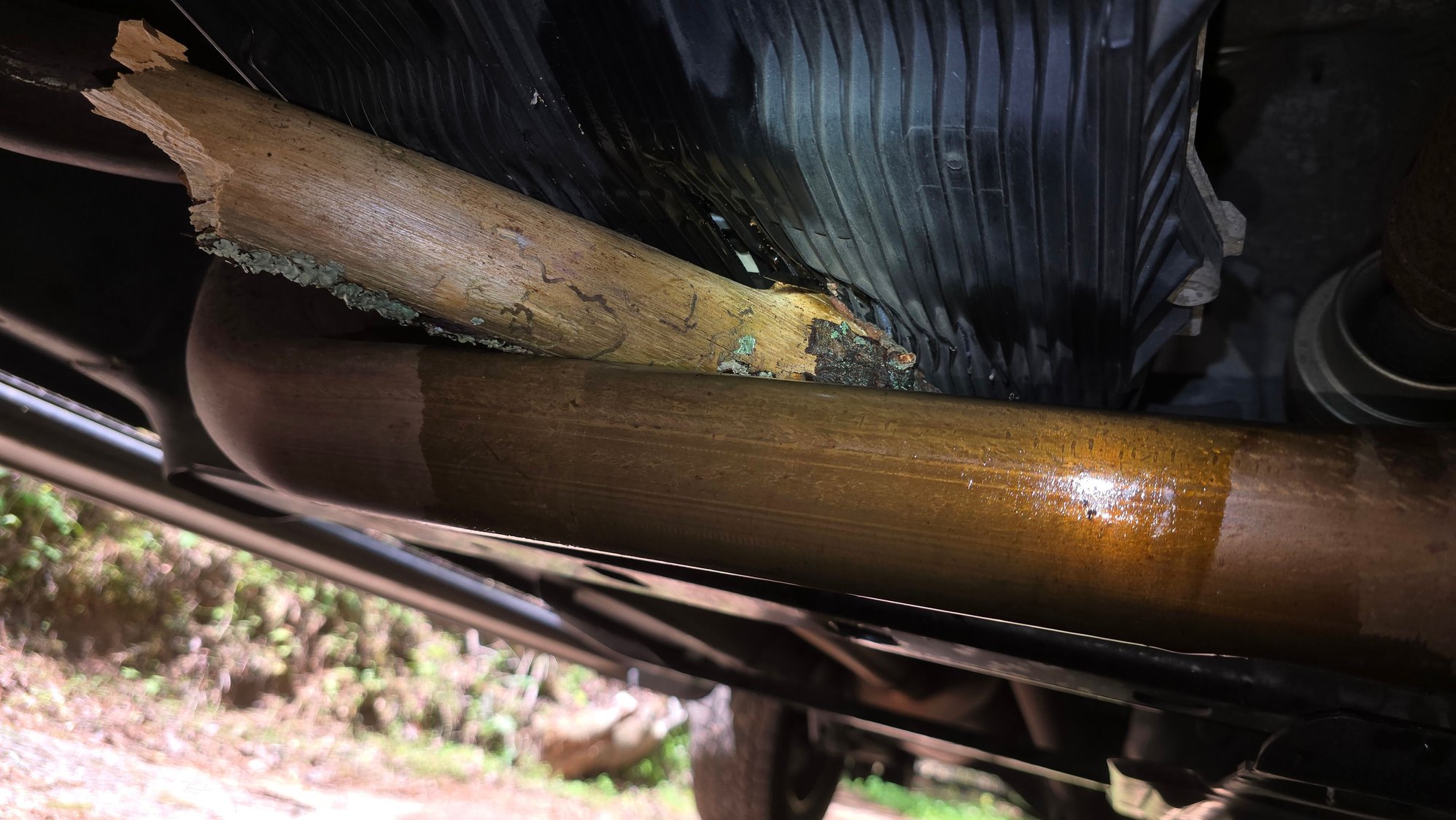

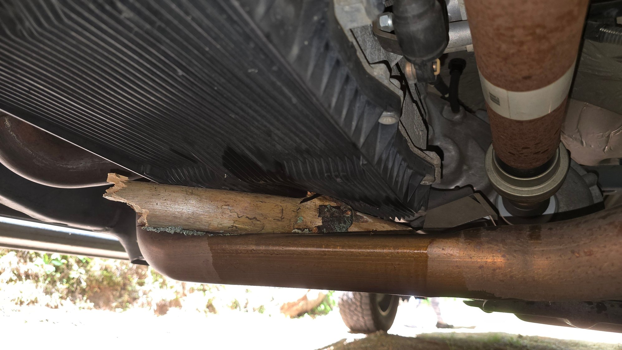

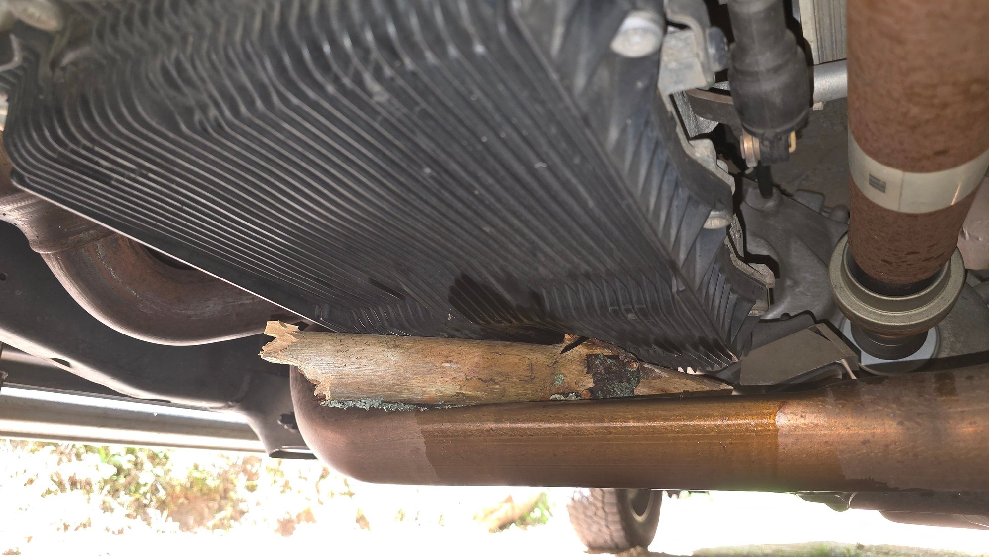

Start walking all the way back to house and found ATF fluid mixed in gravel a couple hundred yards up. Get under truck and found what is shown in the photos. Speechless. Truck is stuck in driveway 600 yards away.

Punctured the transmission pan. Need to replace that and fill it back up to determine if any more damage was done. Unfortunately, you will need to tow it.

The trans uses the ATF to lubricate everything, so, running it low DOES do damage. You don't wanna do that. I know it's an inconvenient spot, but, you have a choice, change the pan right where it sits, or, haul it back to the house without power steering...... I would NOT run it like that.

Won't be able to haul it back, it's definitely in gear, including front transfer case. I rocked it back and forth and had someone confirm they saw the front & rear driveshaft moving.
Question, with it losing all of its ATF and rapidly at that, why or what causes the truck to not allow changing gears or see what gear it is in as shown in the 1st photo?

The trans shifts hydraulically, controlled by the electronics, if there is no hydraulic pressure, well, it just ain't gonna do much, and it will stay in the condition it currently is in.
