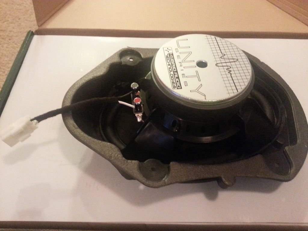

Here is another 6x9 option for guys that want a better then nornal $100 6x9 set. These are more of a sound quailty mid bass 6x9. They are the same size and mounting depth as most oem 6x9 speakers. I used these in my Dodge Challengers, but works with all late model Dodge vehicles. I used the same oem speaker adapter with some minor trimming. If you want the most out of any speaker you need to sound deaden your doors and door panel. This helps the rattles and allows less distortion from the speaker in the door. which helps speaker output. To get the most of these speakers, a nice amplifier powering them. These speakers( Hybrid Audio Technologies (HATS) Unity u69 have a frequency range of 40hz- 6500hz. They come in 4 ohm with push terminals like you find on subwoofers. The mounting depth is 3.35" and 14mm xmax(two way). you can add a 1" tweeters and crossovers to these or 3.5 HAT Unity U3 3.5" Midrange/tweeter alone and make a component set. The U3 Midranges can play low as 250hz - 20khz so no need for tweeter if mounting in the dash. If you ever heard of the Image Dynamics XS69 6x9 component sets that are really good, but these are even better.
Unity u69 vs oem boston 6x9
oem boston vs HAT U69 (much bigger magnet)
oem boston vs HAT U69 (water proof paper cone)
trimmed oem 6x9 oem adapter
HAT U69 mounted to oem 6x9 adapter using all oem hardware(screws)
Bottom side HAT Unity U69 mounted
mounted back in the car, window rolls up and down without any mounting issues.
