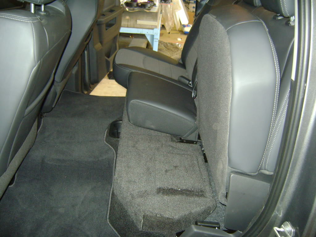

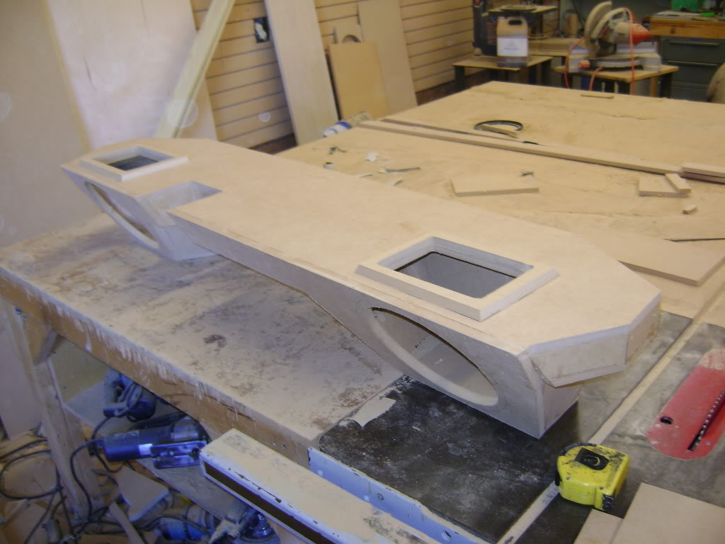

The number ONE factor in Bass is Space
Big space equals big Bass
Small space equals small Bass
And that just Science
Smaller and/or fewer subwoofers Outperforms Larger and/or More subwoofers done Wrong
The available space under the seat of the Ram Trucks is very limited
Not enough space for 12” subs, the space is even small for good performance from 10” subs
The second situation; subwoofers are Not a near field type speakers
Subwoofers require distance between the speaker and the listener to develop the Bass frequency properly
The distance from under the rear seat to your head in the front seats is only about three feet
A very small sub could be fabed under the metal platforms but the output would be so low due to the lack of space would not be worth the work and expenses
The metal platforms would also vibrate and rattle from the Bass
