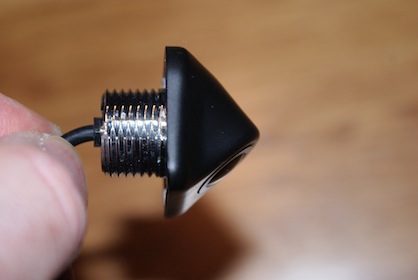

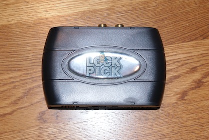

Here are some pics. The second pic is the wiring harness that comes with the lockpick. The large gray and white plugs go into the radio and the factory harness then plugs into the lockpick harness. The cables that go out of the pic to the right are about 2 or 3 feet long and eventually plug into the lockpick. They also have all of the power and grounds you need for cameras ect. The yellow, white and red cables are the audio/video inputs and outputs for things like Iphone input, rear camera or an output to headrest monitors or something similar. The third pic is the camera I bought. As you can see it's a 45 degree angle. I planned on mounting it in the tailgate handle where the factory one would go. Unfortunately, I realized that the 4th gen tailgate handles are already angled so the cam was pointed straight down. I returned that one and I am waiting for the new one to arrive. That one has no angle and will mount in the same place. I got the cam at Sonicelectronix.com. Its a flush mount cam made by Crimestopper. Ill put some pics of that install when I do it. The pic of the other wires is the harness for the cam. You can see a red and black wire and a yellow video cable. That ALL plugs into the lockpick harness. No cutting at all. I have a couple of other pics too but this thing only allowed me to post 5 at a time. I'll try to post the others somewhere too. Hope this helps
