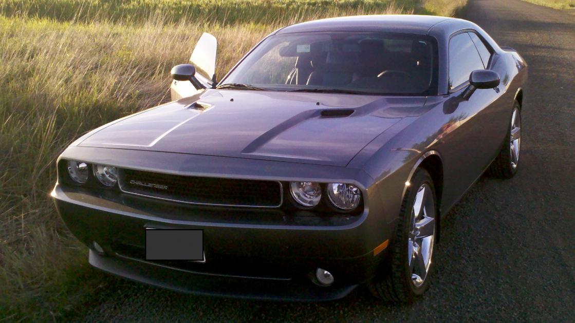

xsdbs: Thank you. I have a 2011 Challenger with the RES 130 radio with Uconnect, build date mid May, 2011. I have never been happy with Bluetooth audio quality, but none of the updates you have posted for 2011 would install. I read thru this thread, and stumbled on the post where you indicated that the update for 2012 should work on an 06-11 unit, so I figured, what the hell, and tried it, and it worked! Bluetooth sounds much better. I use Slacker on an Iphone 4s, and most of those functions work as well, both UCI and Bluetooth. So again, thanks!
Attached Thumbnails 2012 Uconnect SW update-challenger1.jpg   2012 Uconnect SW update-challenger.jpg
