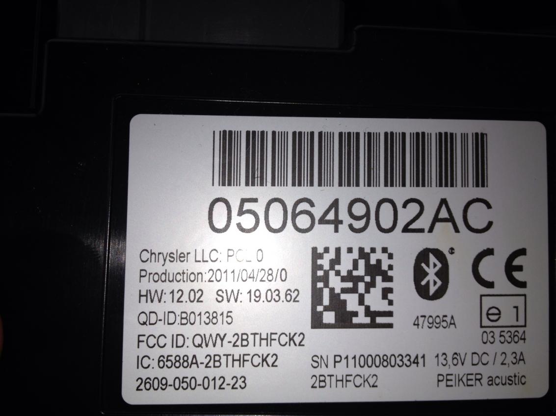

The kit was installed when the car was brand new delivered, August 2011. I dont know where they installed the uconnect module or how i would access it, the cable end is just a white ipod 30 pin connector.
UPDATE: Just looked at the uconnect module (i find it under the transmission) the part number is: 05064902AC SW VERSION: 19.03.62
If it is the 2010 uconnect, can it still be updated to the same software mentioned in the bulletin.
See the attached photo for more info. It only has two connections on the back, one for the connection to the radio, and the other that the ipod cable connects too. no spot for a usb cable anywhere? this is weird, would a dealer be able to update this?

Thank you for the description and picture of the Uconnect system. My thoughts were correct about you having had the 2010 kit installed and it's probably next to impossible to get the dealer to do anything that will help you out. The 2011 and newer kits have new hardware in them that allows more enhancements and memory for SW updates. Older phones didn't have all the abilities that the newer phones have so they didn't require much.
As you see your module has only 2 connectors and the 2011 unit has 3 connectors. (see picture below)
Now it is possible to replace the module and USB / iPod cable while still using your same harness and mic that is currently installed. I don't know what the dealer there would charge for the parts but you might want to look online for a Low Speed Uconnect (PN 82212499) and the optional cable (PN 82212160). The kit will come complete with a harness, module, mic & install directions. You will be better off buying the kit vs trying to buy just the module & cable. This will be a direct plug N play setup with no visits to the dealer for programming. Let me know how much you find the PN's above for, I may be able to help you out. I have already helped a couple other people outside the US.
