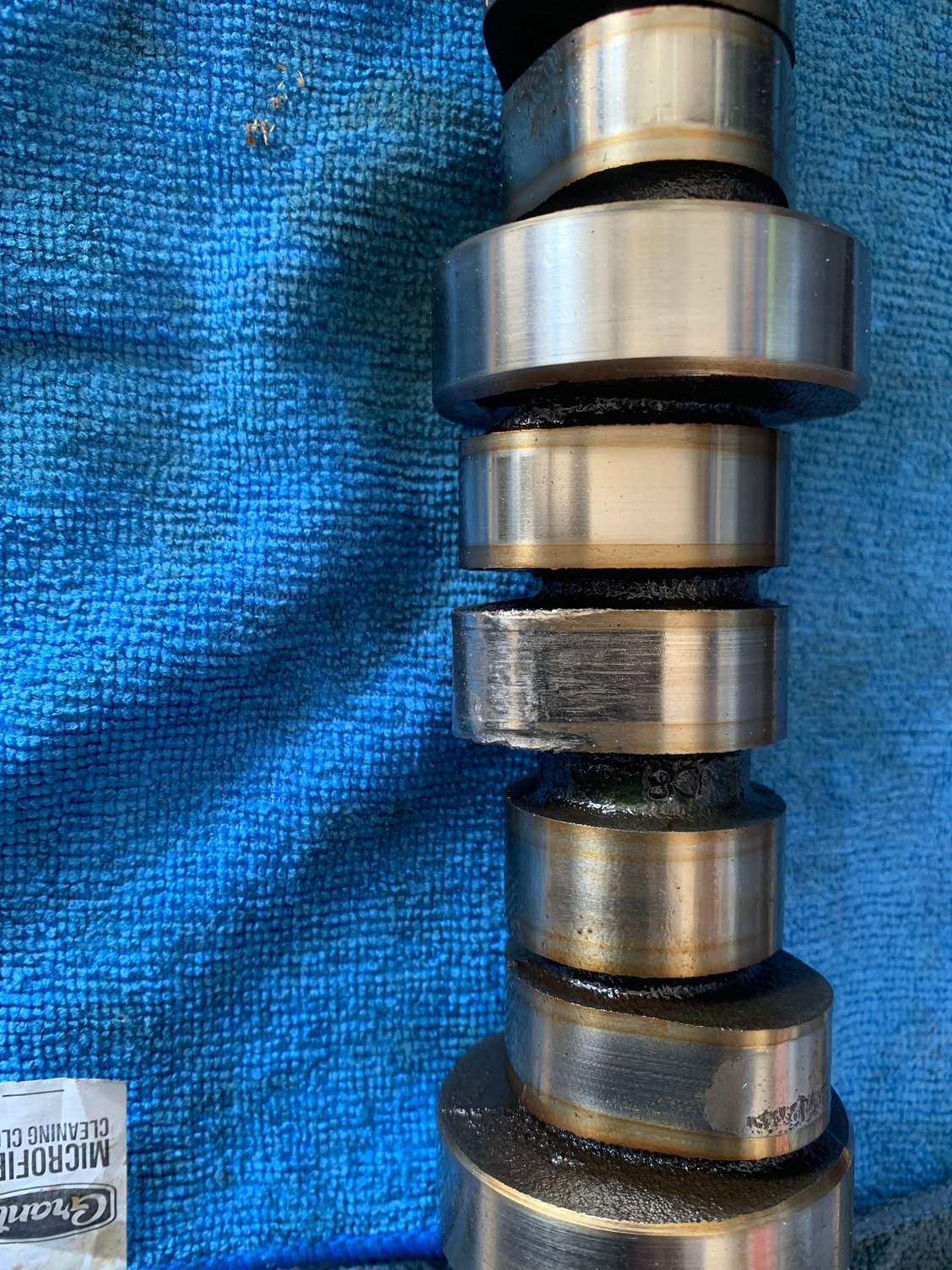

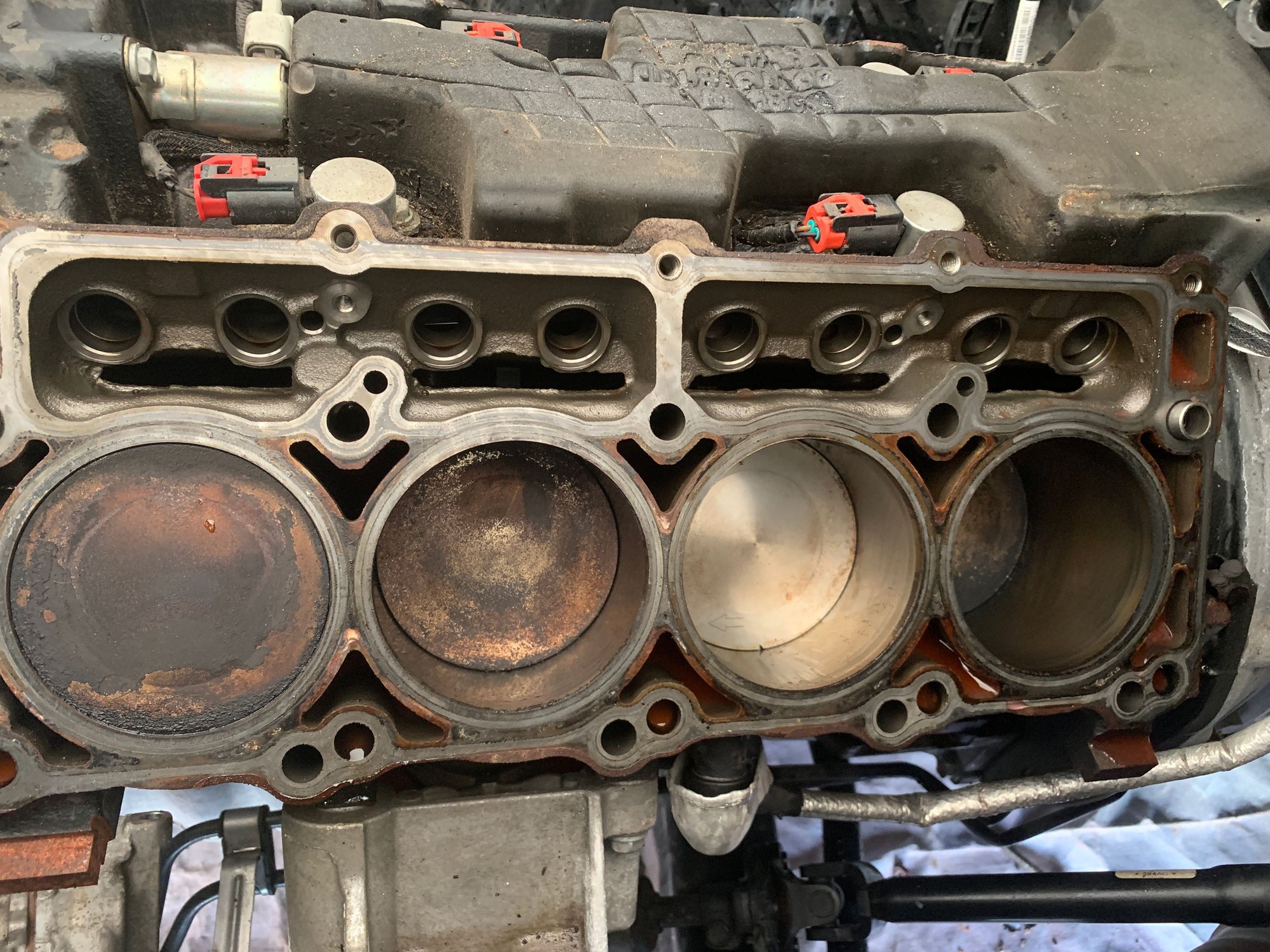

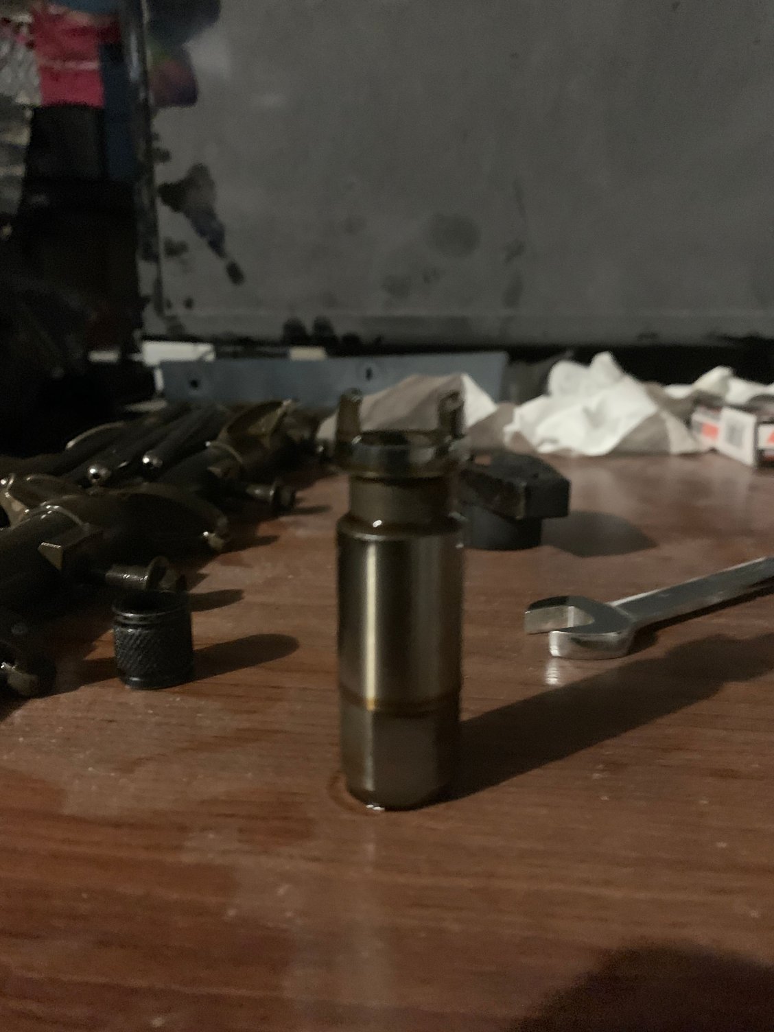

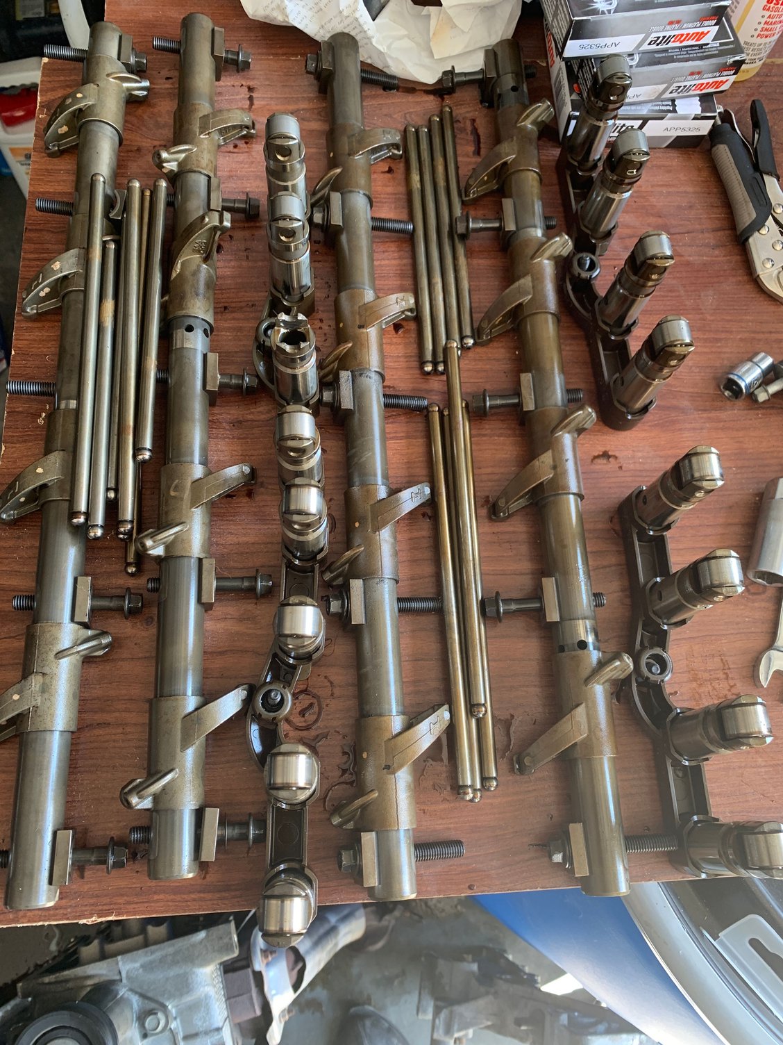

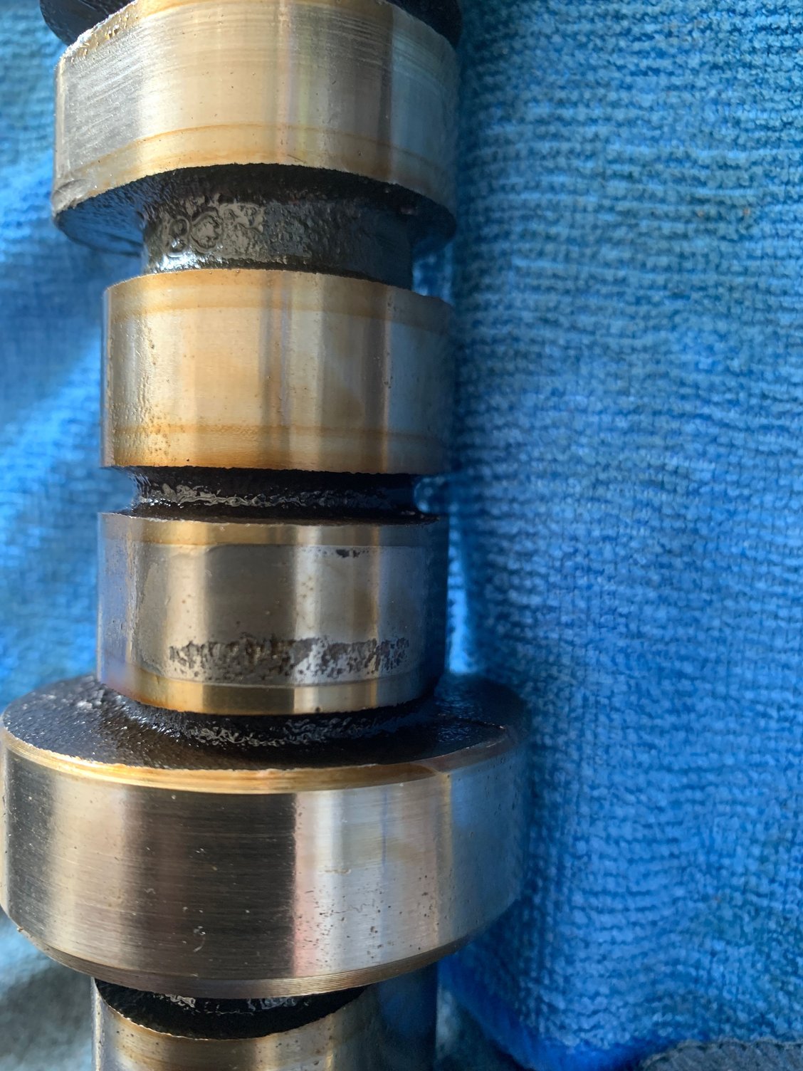

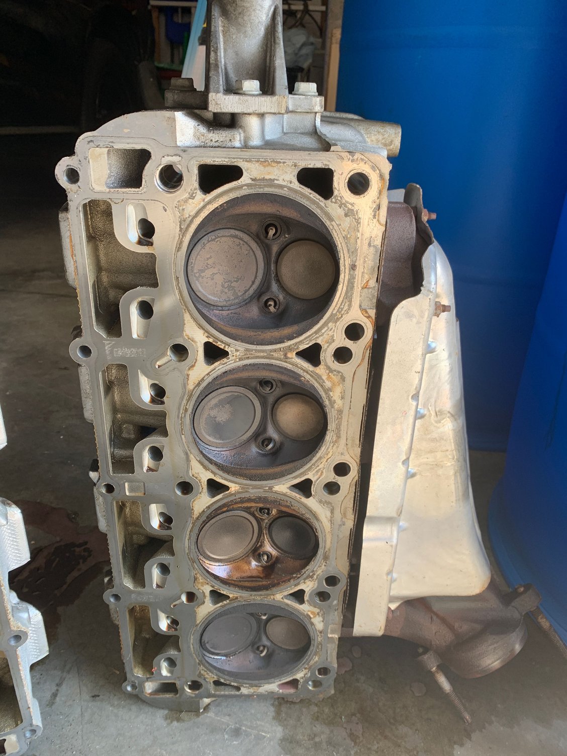

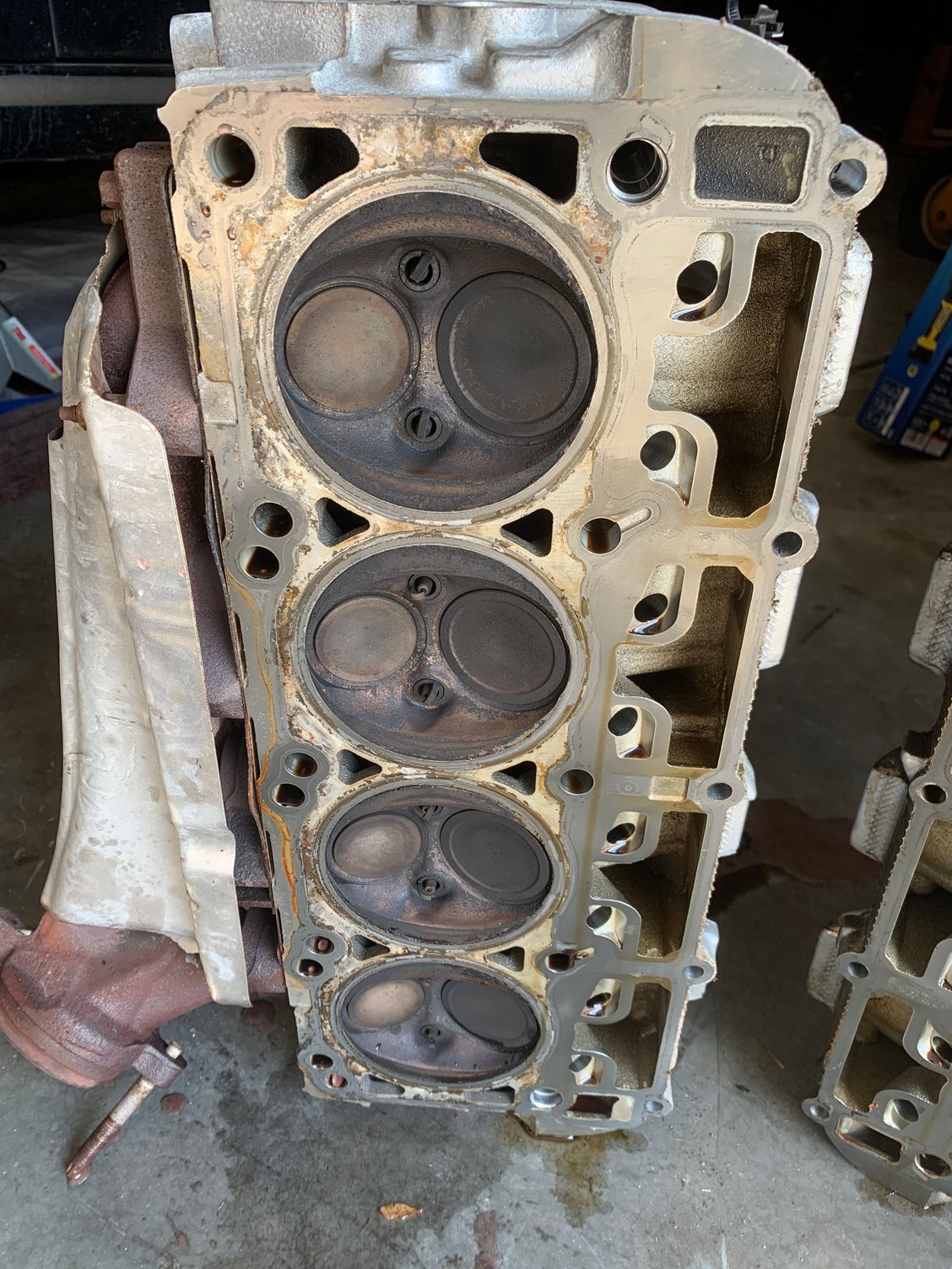

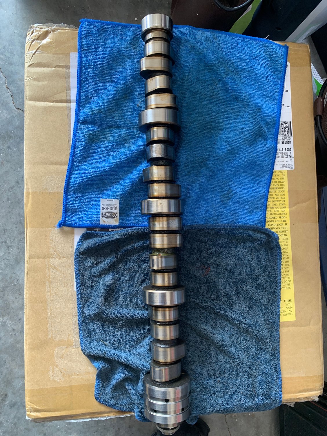

I got the other head and lifters out and they roll free and have no issues. I also got the cam out and it has some wear but not as bad as I’ve seen others have posted. Here are the pics
The cylinder 5 piston looks like it’s new. Is that possible or is it clean from not burning any fuel.
Passenger side
All the lifters roll freely and have no scarring except the one for cylinder 5 intake.
Light scarring on the intake lobe.
Light scarring on the exhaust lobe.

Replace the cam, and ALL the lifters. Otherwise, you are going to get to do this job again, and likely fairly soon.
Wonder if #5 was sucking coolant as well.... That's awful clean, even if it hasn't been firing for a while.

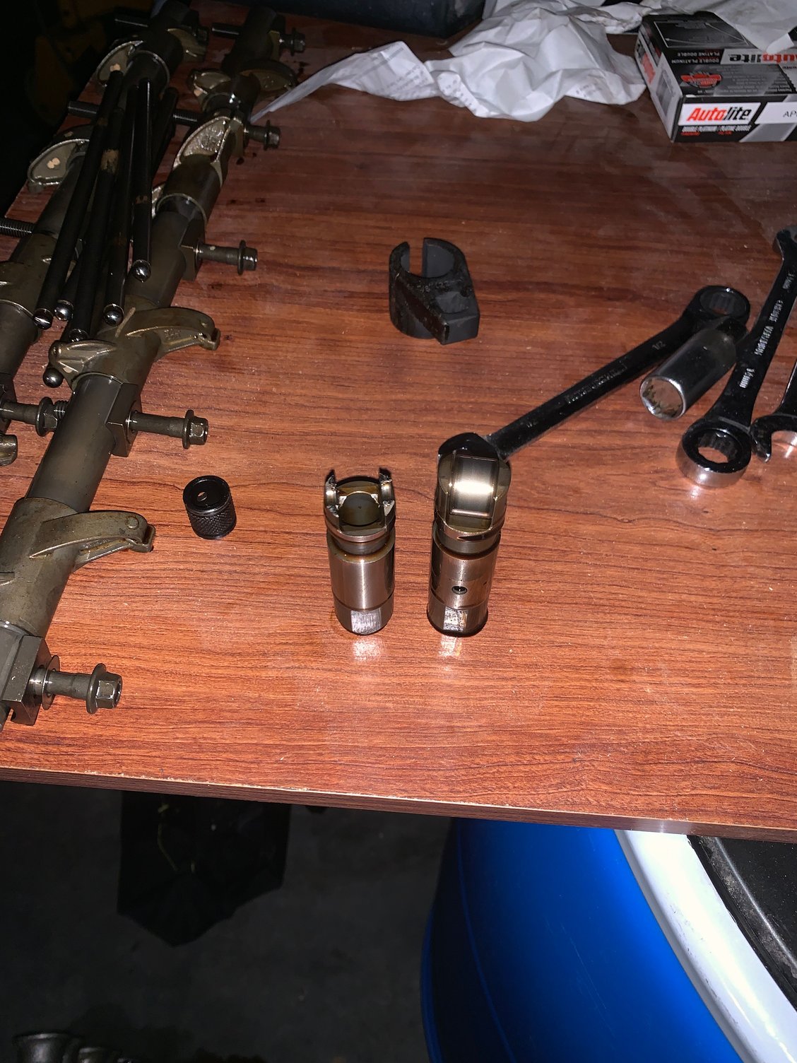

I finally dropped the oil pan. Here is what I found. This looks like all the pieces.

Is that what's left of the roller from a lifter?
