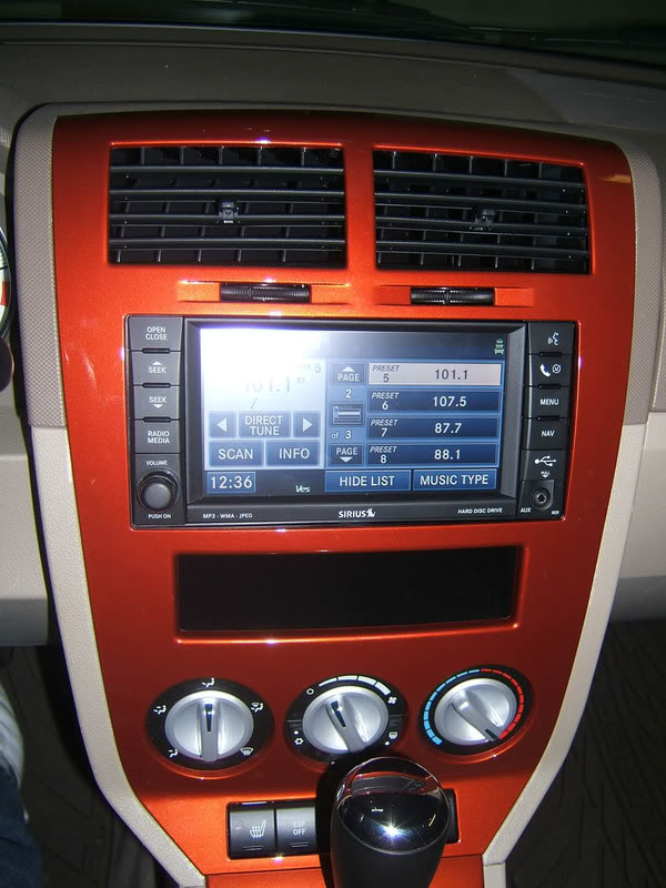

I installed the MyGig in my 07 Caliber and it works perfect! I had to use the Lockpick Adapter in order to connect it to my stock wiring harness. It's all plug and play which is nice so the install is pretty easy. The MyGig has the Sirius tuner built in so I bought a Jeep Wrangler sirius antenna kit. I connected this to my stock sirius antenna right above the headliner and ran it across to the A-Pillar and down behind the dash and into the MyGig. Great success! Everything works great!

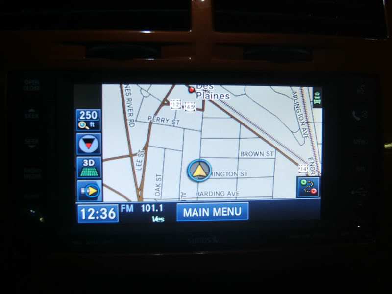

I love the NAV! I installed the nav antenna right on top of the radio, just behind the bezel. It has no obstructions and I have no issues with the NAV. I've read that the nav will go kind of haywire if the antenna can't get enough satellites. Luckily, I haven't had this problem.

I called my local dealer to ask them about the bezel from an '09 and they told me I needed to give them the VIN from an 09 with the bezel I needed. So I looked on ebay and found an 09 sunburst orange Caliber that had the bezel I needed and the listing had the vehicles VIN. I called the dealer back with this info and they found the part number and ordered it up for me.
Mygig unit - $600
Lockpick adapter - $200
bezel - $180
