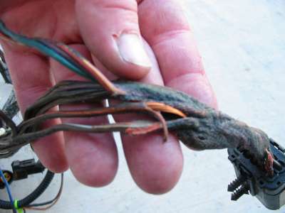

After messing with this Van for a month, I think we've finally found the problem. The first thing we replaced was the rear O2 sensor. This was melted and sending out false signals. We tried the throttle position, MAP, Coil, plugs and wires, PCM, and cleaned the Throttle body. Every time we'd change something we'd get different symptoms. All of the original parts were reinstalled. The only solid code we got was for the MAP, so we changed that again. But it still threw MAP codes. Found that the sensor wire for the MAP was shorted to ground. So we ran an external wire from the sensor to the PCM. Now we were able to get it to run consistantly, but it had a miss at idle, and would backfire every once in a while. Since there was a problem with the MAP sensor wiring, we removed the entire engine wiring harness that this is what we found. The harness for the fuel injectors, MAP, and Cam positon sensor (I think it's the cam position sensor) was completely melted together.
(See attached pics) We're currently in the process of repairing the harness and rerouting the wiring away from the exhaust and power steering resivoir. The connector that had the most damage is directly behind the coil, closest to the dash side. It runs right by the exhaust and by the power steering resivoir. I'll update this again as I'm sure we aren't the only ones with wierd problems like this...

I would like to say thank you to this forum and the poster of this thread with photos.. After plugs, wires and a new coil, our 01 Caravan started acting weird.. Fouled plugs and host of other odd symptoms.. Many hours, calls, and checks till I found this thread.. After removing the wiring harness and soldering in new wires, replacing three more fouled plugs.. its back to running well with over 200K..

My 2003 town and country was misfiring so bad and blowing white rich gas smoke then cuts off. I immediately thought it was spark plugs issue. I changed them but I kept having the problem. Then I went back to that harness the poster mentioned and I found the exact same issue as the poster's pictures. I scraped the old brittle wires and (isolated) retaped them temporarily just to see if this fixes my problem. Sure enough, the car ran immediately but now I have a rich white gas smoke coming out (but became lesser). the code I am reading was P0108 with an engine light on.

hi i had the exact same problem for 2 weeks could not solve untill i opened the wire harness behind the coil it was a wonder the car ran at all the wires all melted together so i seperated them and taped the up now car run perfect thanks to the person that posted the problem !!

Thanks so much for a great forum, to norcalvp for posting this problem & solution with pics, and dodgehead for posting the location to find without completely removing the harness. My 01 T&c had me banging my head against the wall for over three weeks, and this was my exact problem as well.

Yep that was the problem. Thanks norcalvp, you saved me big time on this one. All of the insulation on all 8 wires was melted and gummy.
