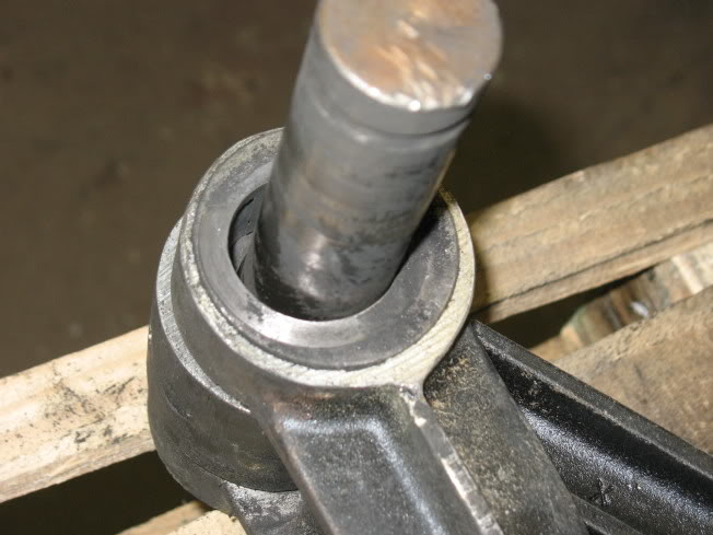

You are correct, But, I'm a better pinsetter mechanic!
I started in the bowling biz in 1972. Working on the machines in 1974.
They are truly an amazing machine that never fail to test my experience.
No matter what type of machine we all work on, worn out parts is worn out parts.
Does this look like it may cause a problem?!?
