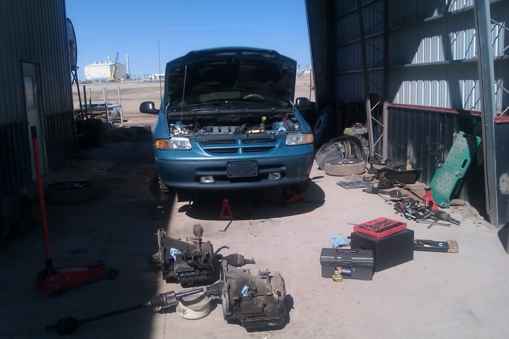

So, as some of you know I lost the transmission in my beloved Turtle Van during our west coast trip.
Being stranded in "Wamsutter, WY" (No, I didn't make that up!) is not what we had in mind for our trip.
I did the trans swap right there at the truck stop and finished our trip.

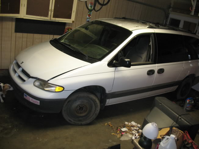

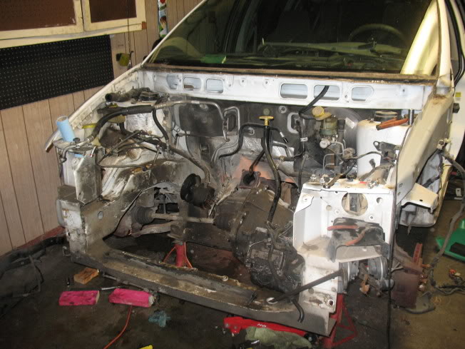

Months before, I found a $400 GCV on craigslist that I bought for parts.
