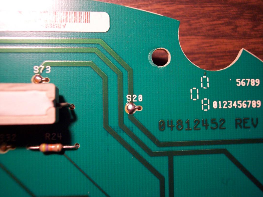

Have read up on the cluster solder joint problems,but have not found any reference to the odd thing i've found on my board.That being alot of solder points that are not soldered.My camera cannot get a close enough view of this so if you can bare with me in an explanation I would appreciate it.
These solder points i'm talking about do not involve any components.Rather,they connect (or almost connect) a circuit trace on one side of the board to the other side of the board.there is a short length of wire that feeds thru a hole in the board and is soldered to a trace,but on the other side of the board the end of the wire is just a hair shy of contacting the bulb of solder on the other trace.
They look like they should be soldered together,but there's so many of them like this I can't imagine how the cluster would have ever functioned at all!
This is a bit of a maddening thing because if these traces on both sides of the board weren't supposed to be connected why go to all the trouble to feed a wire thru,solder it on one side,and put solder on the other side,but not solder the wire to it???

In this case it's some easy soldering.Whats interesting is I took the board out of the original cluster,that this one was purchased to replace,and found that these solder points were completed.
These must all be grounds and it probably isn't necessary that they all be soldered together.I'm going to go ahead and finish the soldering and we'll see what happens...

It has macro,but it's only good to three or four inches.The distance between the solder and the wire is so small I would need to get as close as an inch so it could be seen.
I do have some pics though..i'll post what I have to at least give a better idea of what i'm talking about.The solder point in question here is at the center of the picture.

You can barely see in pic 2 that the solder had been flowed towards the wire,but does not join it.If I could show you a closer shot you would see that there is not a break and it did not come loose.If a machine soldered those joints it had to have been out of spec.,if a human did that.....and where was Quality Control??
And like I said,the other board this one replaced had most of these joints soldered.

OK,soldered those connections and didn't make a bit of difference..on to the next!
