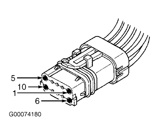

Handy with a multimeter? Looking at a wiring diagram you should be able to check continuity through the TRS to verify the switch is bad before changing it. The TRS connector should be the only vertically mounted connector on the front right of the transmission. Checking at the connector mounted on the transmission, you should have continuity (near zero resistance) from both contact #5 and #10 to ground with the shifter in park or neutral. With it in any other position you should see no continuity (infinite resistance).
Problem could be the connection itself. Is it clean and not saturated with tranny fluid?

I'm assuming backprobing to the the actual connector while it is still attached to the TRS? I've also cleaned the connector and TRS with QD electrical parts cleaner to no avail.

No. Disconnect the connector and probe the connector on the transmission. At the same time you can check to see if it is saturated with transmission fluid.
