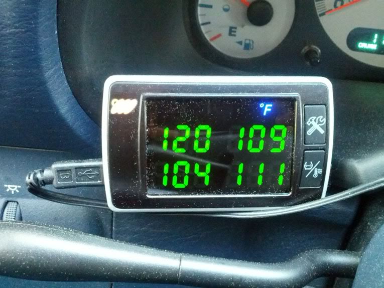

I have this left front clicking when turning at full lock and have suspected the CV to be bad and recently installed a tire pressure monitor that shows the same wheel to be hotter than the others.
Is this tire hotter because of the exhaust being routed that way?
Is this just another sign? Excuse the pine pollen dust. The tires all go from 36 psi cold to 39psi hot but that front left is hotter and goes to 41psi.

Funny, if not for the tire pressure monitoring temp read out I would be obliviously happy. Its only a 10 degree thing but it bugs me.

The sensor reads the same at ambient and climbs along with the other three and then goes about 10lbs more. The tire pressure is also a tad higher on that wheel too.
When lay my hand on the wheel it feels a tad hotter.
I'm thinking a brake problem would be much hotter eh?
