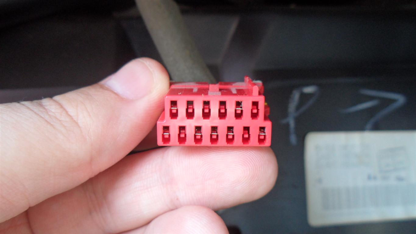

I resoldered the red plug and it still does the same thing. It doesn't work in the morning, but works in the afternoon.
Ran the instrument panel tests. Passed all of them and code 999 (end of test)
All fuses are good. No melted wires in back of A/C control panel. Plugs for the BCU are snug. Posted a picture of the plug in the van. How can I tell if the terminals are spread and not making contact? I wiggled the connector and didn't help getting the dashboard to work.
It did work after putting everything back together, no problems what so ever. Had the battery disconnected the whole time.
Any other ideas that could cause the instrument panel not to work? The needles still wobble even when the ignition is off up to a minute. Odometer also doesn't work when gauges are going crazy. All I can think is a bad ground (where?) or the instrument panel is bad (can get a used one on ebay for less than $100)
I need some help It's the only problem with the van. Also can't afford to bring it to the dealer, hence why im driving a 16 year old car
I do not know how fast im driving half the time, which is dangerous, plus im less than half a tank of gas as far as I know.

It's not the solder joints at the connector that break, it's other joints on the board, usuall the jumper points. There are pieces of wire that jump a circuit line from the front of the board to the rear. Those are what I find cracked on them, the new circuit boards eliminate them and the issue.

Should I attempt to resolder those connectors or go ahead with a used cluster? Hopefully those don't have the same problem.

Basically you have a used cluster, if you get another one, you'll just have to fix it. So try and repair the one you have first. And no, no LCD display for the 3 speed trans.
