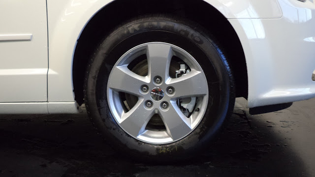

All,
I did find a dealer online with wheel pictures of their inventory. This is a 2013 SE with the 29E package that includes 17 inch wheels. It very obviously has dual piston calipers. Looking at how little room there is between the wheel and the caliper, I also can't imagine a 16 inch wheel fitting over this.

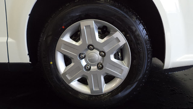

The same dealer had some SE's with the standard 16 inch steel wheels. Nothing to see here unfortunately. The black steel wheel blocks nearly all view of the disk and caliper.
Still hoping somebody with a 2013 with 16 inch steel wheels can confirm the front caliper type and disk size.

Again, the latest big brakes REQUIRE 17's to clear. If you have 16's they are the standard 12" diameter brakes used since 2008.
