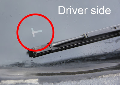

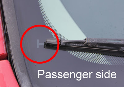

When you adjust your wipers they should be set to the alignment marks on the windshield. Here are two pictures showing the marks.
NOTE: I moved the wiper down in the "driver side" picture so the alignment mark would be visible. The wiper should be right on the mark.
George
George
