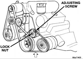

this is the AC belt I am talking about. the main serpentine belt has its own tensioner that you do not adjust.
everywhere I search, I see this but it tells me nothing.
"Adjust to specification by tightening the adjusting screw. "

How about right 2/8 till it stops squeaking/slipping? The belt is either too lose or too tight, probably too loose. You likely won't find the actual spec unless you have a mopar or hayes manual handy..
UPDATE: Did mine today. counter clockwised the bolt up about 1/4, loosened puller bolt, took belt off, later after other work: put belt back on, tightened pulley till about the torque it was when I took it off(judging from turn power), used ratchet to tighten adjuster bolt till it was snug and kept tightening ~3/16 till I could barely flex the belt. Seems to run fine.
