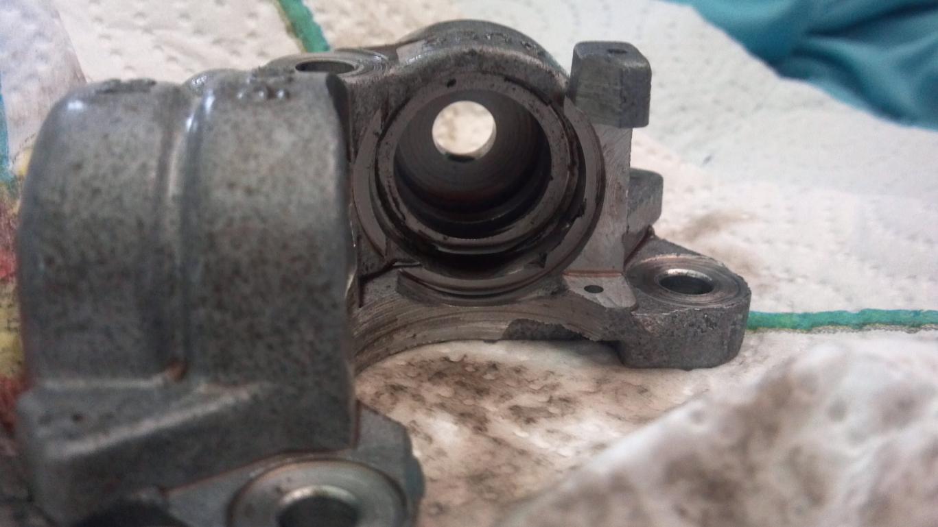

so i got the governor body out and the valve (smaller one with no spring) ever so slightly hangs up when you first try pushing on it from the back side, also I noticed the bigger one, i believe is the weight, has 2 marks on the outer edge its bore, sort of on the bottom right of it. i attatched a picture to see if that is damage or if that is supposed to be there. Looks like damage of some sort to me

after a few more min of looking it seems those notches are supposed to be there, i'm going to get some really fine sand paper and see about cleaning it out a little. And I lost the little "nail" that holds the larger valve in... I'm gonna look for a replacement. Also there wasn't a filter in my governor where everyone says there should be

That valve body looks a bit beat up. I would replace it. And the nail is just a finish nail.

thank you master tech, I ended up sanding it a little and the valve moved much better, i found the nail and the filter I thought I didn't have. That filter must be magic, i swear I never saw it fall. put it back on, the valve body, had to sit back and figure out how to get linkage back together on the valve body. Had to buy some E-clips i lost. (working on dirt sucks for dropping small things). Bolted up, filled up with fluid and now it shifts great. I am so relieved, never done that before. Wasn't that hard
