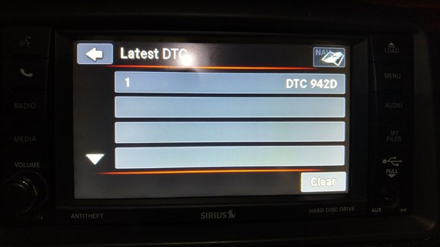

Hey guys,
New here on the forum. I just purchased a 2015 GC R/T with 44K on the odometer, and loving it so far.
I was playing around with the radio, and came across a previous DTC code of 942D. I've searched everywhere and can't come up with any information on the code. Does anyone know what this code means?

I really don't have any other info to go on.
Here is a pic of what I'm referring to:

how ya get the radio to give you that info? DTC? my radio is a rer and I never seen that on there?

I'm going check into this further. Can you send me the last 8 of your Vin thru a pm? I want to contact star on this.
