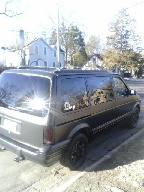

Not on a 5th gen, but I had duals on my 95. It was single 2.5" pipe from the manifold to the back. After the axle there was a Y-pipe which split it to dual 2.25" pipes, finished with oblong tips out the rear.
I was running a Walker SoundFX muffler, it had a very awesome sound with a deep tone, but was not annoying to drive:

I had my setup custom made at a local shop. It was full exhaust from the manifold back. It cost me $250 to have it done, I brought in my own muffler and tips.
If your neighborhood shop wouldn't do it, go somewhere else.
The stock exhaust on vans is extremely restrictive, at least the older ones were, so upgrading the exhaust netted me better top end performance and better mileage. Not sure how much could be gained on the new vans.

Your working with a minivan, not a performance vehicle, therein lies the difference. Most non-performance vehicles have very restrictive exhaust and intake systems and can benefit greatly from simple intake and exhaust mods.
I would be willing to bet the Challenger manages an extra 22hp over the same engine in you van from having better flowing exhaust system.
