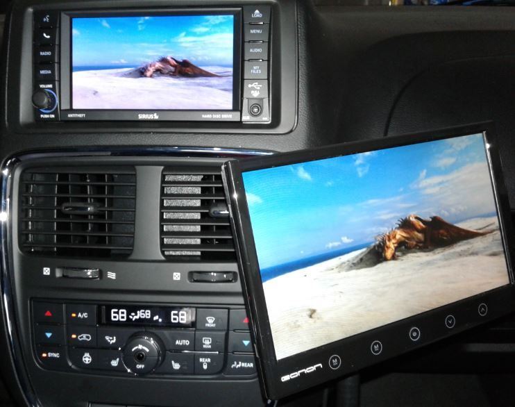

Well I had no luck with a stereo shop adding a screen so I tore into it today and figured it out. I fabbed up a test wire and powered up my additional screen. I then popped in a DVD to send the signal down the wires. Through trial and error I found the video signal and was able to tie into it and install the front seat screen. The screen looks big in the pic but it is only 9 inch. It plays just like the back seat screen. When in drive the dash screen goes dark but my new screen does not. A dozen shops I contacted said it could not be done. The nice thing about the system is the passengers can watch DVDs with headphones, but the driver can still listen to the radio.
