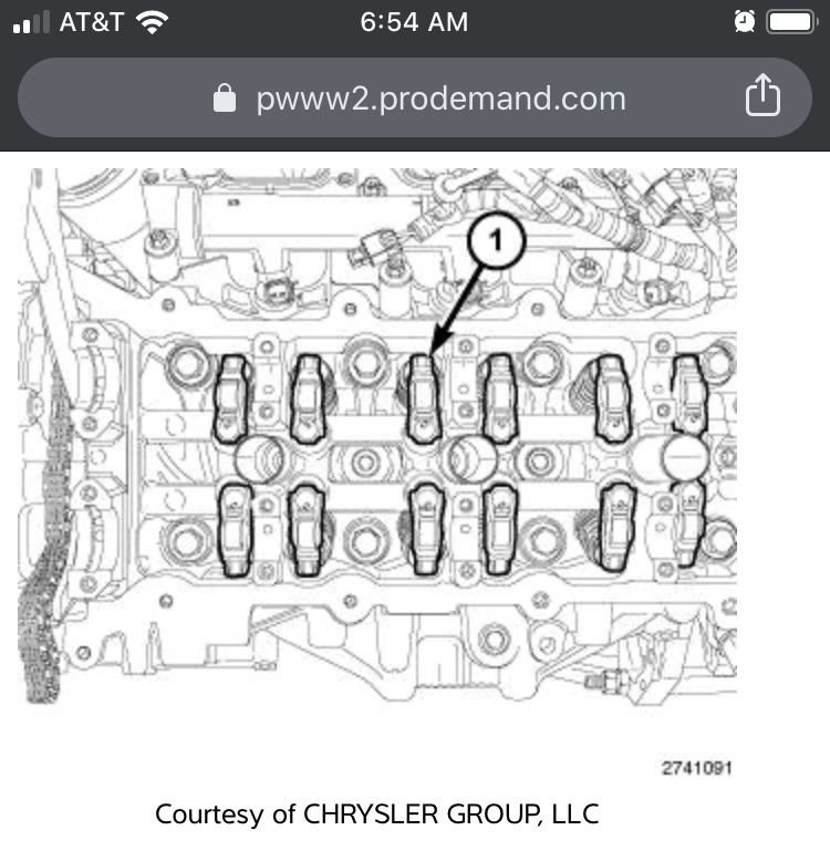

1 & 2) The illustration below is of the left cylinder head with the cover removed. There’s 1 lifter per rocker arm and the number of lifters and rockers is the same for each cylinder head. Are there some problems you’re having that have you contemplating replacing these or removing the heads or cams?

#1 are rocker arms

Thanks for the reply GumbyRT, I've been offline for a while. My engine has 110K, I've replaced the belt, but the tensioner doesn't seem to have a line, or an arrow as a wear indicator, but according to your recommendation, I'll replace it very soon.
I was asking about rocker arms because I've had to take the intake apart twice to replace ticking rocker arms, and have to take it apart it again soon, and thought it might be a good idea to replace as many as I can while I am in there, and put in new lifters too. I have this mentality where, I think nearly every small component will be near the end of its useful life by 100K, and if I can replace that part while I am in that area replacing another part, why not replace it under preventative maintenance? Since I am at 110K, I feel like my starter could give at any moment. I grew up in the 70's, & 80's, & by 100K, cars were nearly shot. I know times have improved, but it's hard to know by how much exactly, especially when you hear phrases such as, "They don't build them anymore like they used to!"
